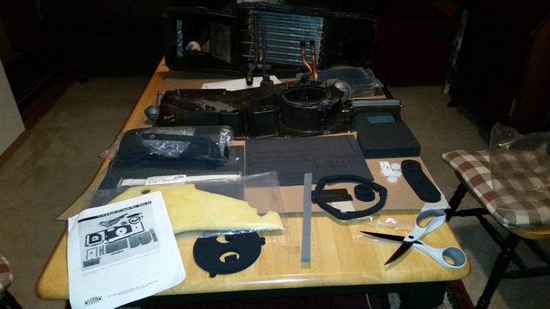

I'll see if I can find the link to a website that sells the gasket kit. I did mine 3 years ago take lots of pictures of the hoses just in case they come off when taking it out of the car. Like they said above take the passenger seat out it makes it easier to remove. Be real gentle taking it out it's old and can be brittle in some areas . If you need any help just message me instead of asking me on here it will be easier.
Found it.
https://www.detroitmuscletechnologi...ater-box-rebuild-restoration-seal-gasket-kit/

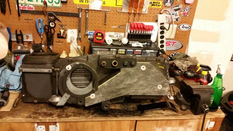

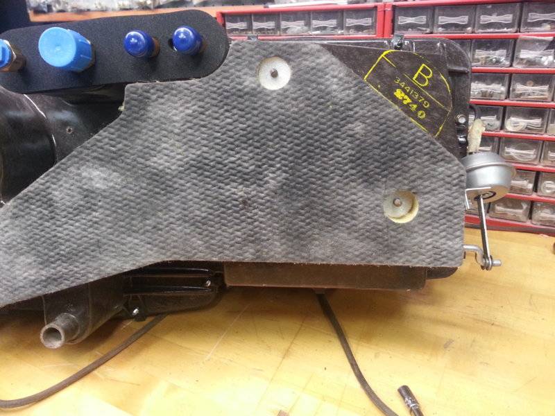

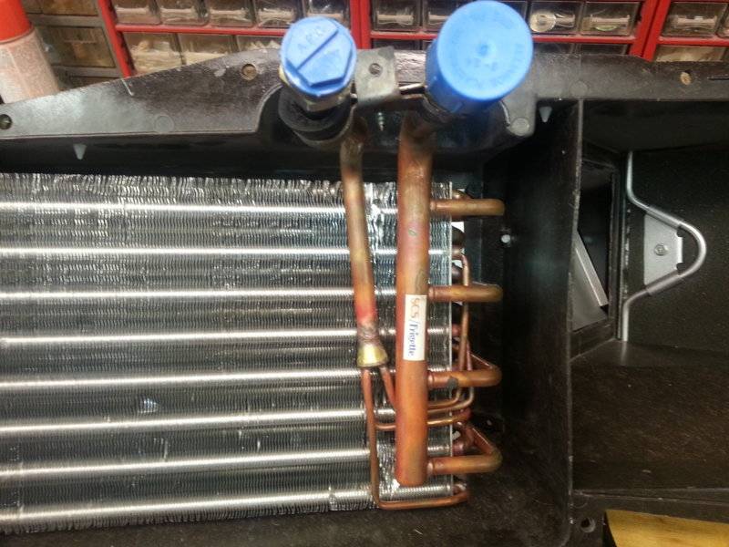

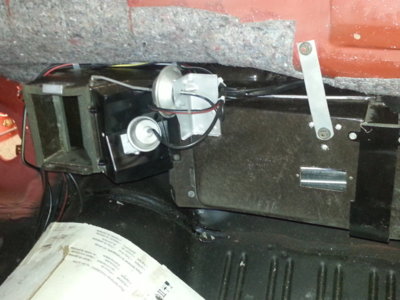

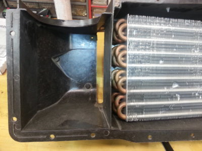

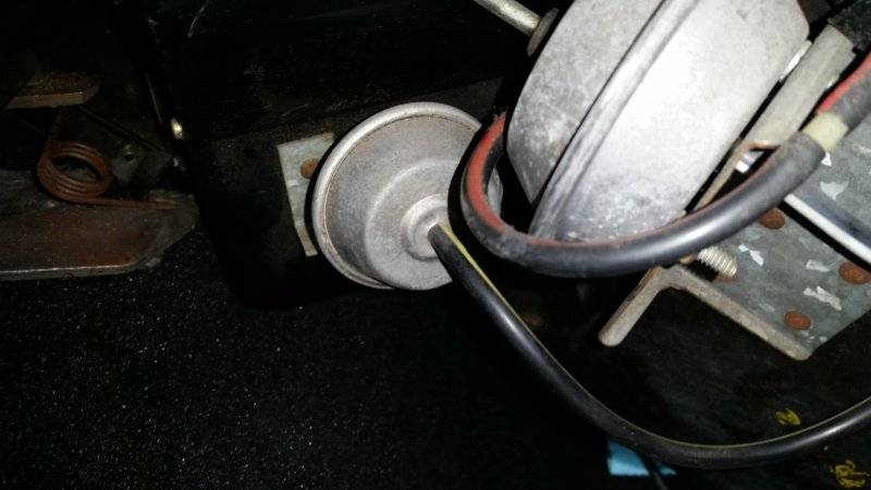

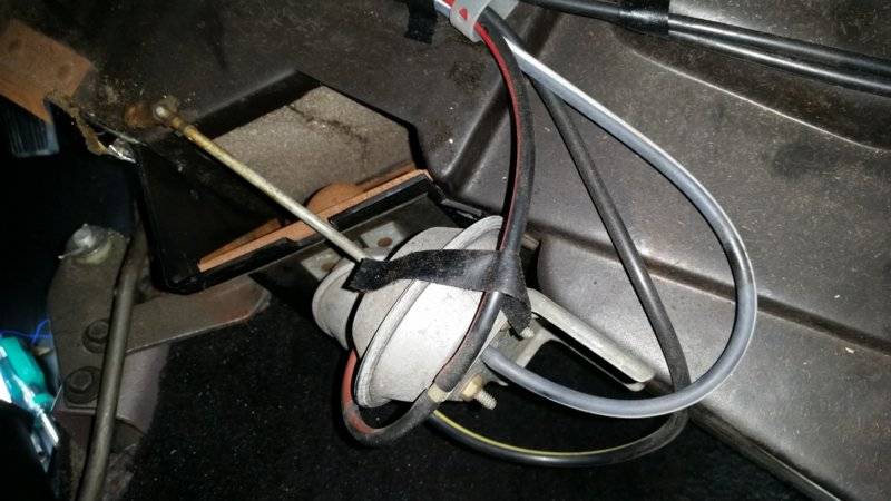

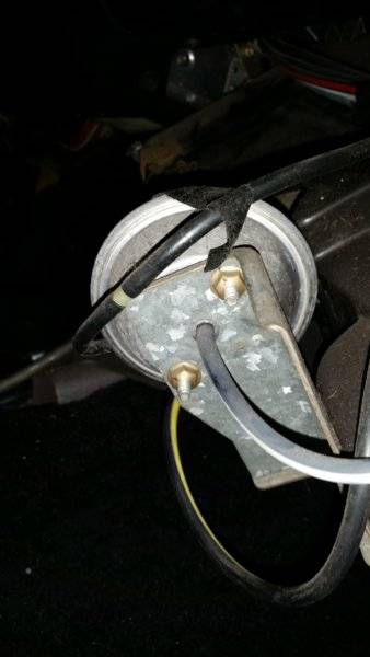

Word of advice, Lego...Take LOTS of pictures and label things!!! Sure, Jim's gasket kit has some pictures but as more insurance, take your own. Here are some of mine
20150117_150430.jpg 20150117_150437.jpg 20150117_170833.jpg 20150124_170318 (1).jpg
i am doing the same on my 72 se .i have my interior completed utted and box out with plenty of pictures of a/c heater box. one thing to take note of is your vacum hoses are clor coated just like your wires and it helps with putting them back in the correct locations as you refer to the pictures you take any questions pm me

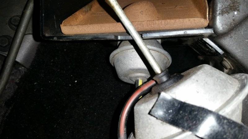

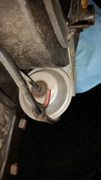

I'm trying to find the vacuum actuators that are shown in these pictures, but can't seem to find them on any of the main parts distributers. What is the name of this part I should be looking for? I tried heater vacuum actuators, heater control actuators, .... but nothing comes up. Thank you.
Didn't see it mentioned-
Vacuum nipples can get extremely brittle.
Be super careful and maybe use penetrating oil.
