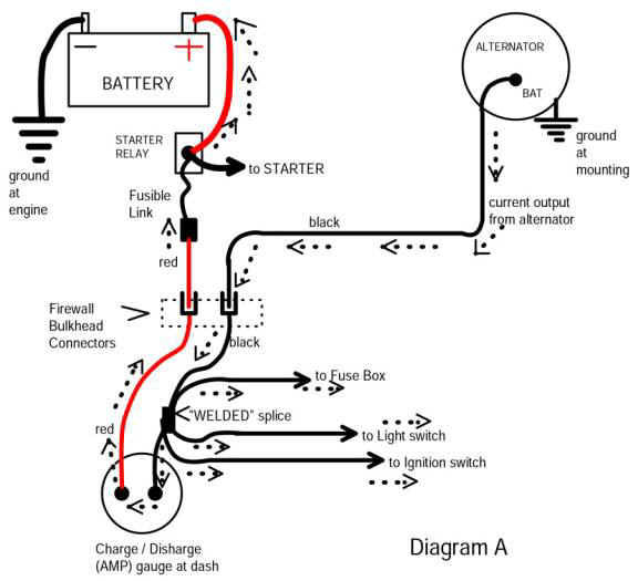

You are talking about the 10 gauge wire from the starter relay thru the bulkhead connector to the ammeter? This is where most dash fires start. I just did mine due the bulkhead connector melting. 16 gauge fuseable link soldered to 10 gauge straight thru bulkhead connector eliminating the spade terminals to the ammeter.
Forgot to add, this was caused by a short in the ac/heater motor wires that I also fixed. Hopefully in your case, your short was also corrected.

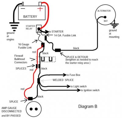

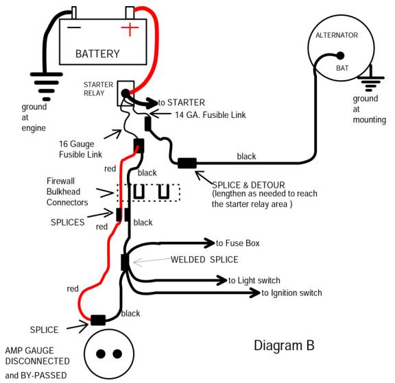

Lots of people do this fix to eliminate the ammeter, and the melting bulkhead problems. Here's the before and after schematics if anyone needs them

I didn't bypass the ammeter. I ran the correct 16 gauge fuseable link and 10 gauge, but eliminated the blade connections on either side of the bulkhead connector.
