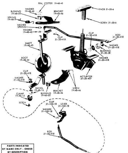

I'm rebuilding the shift linkage from the slap stik to the transmission. Looking to see if anyone has the picture that shows and calls out all the washers, spring washers, cotter pins and clips used to attach everything including the lower shift rod at both ends. I think mine has some missing pieces. Thanks.
From the parts book pg 21-7
