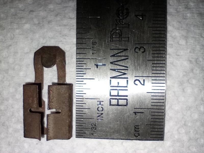

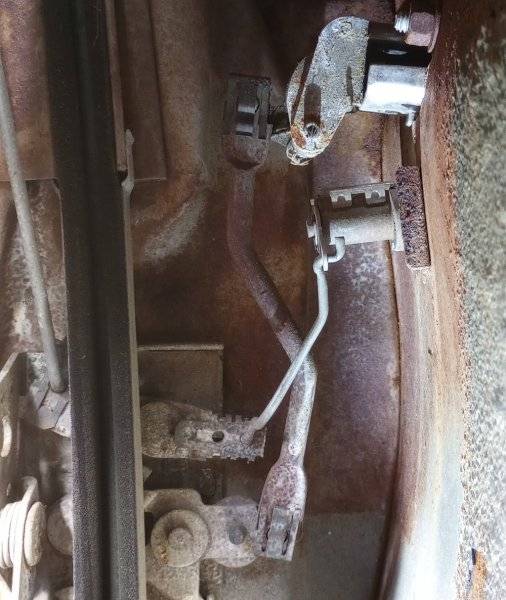

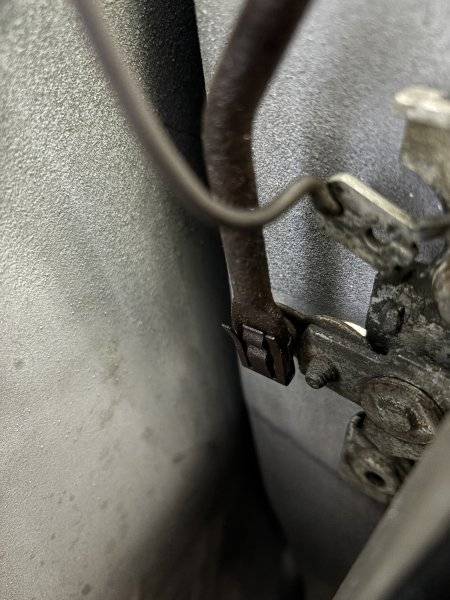

Hello I am assembling my 66 the shop the car was at replaced the lock cylinder , I was able to find the small rod from the cylinder to the latch , but the shop never attached the rod correctly and left out the lower clip that retains the rod . It is a small flat metal clip , does anyone have a picture of one of these clips or have a source where I can purchase one . The ones I received from Rt specialities are not correct and do not fit . I need the clip for the lower connection point show in the picture .

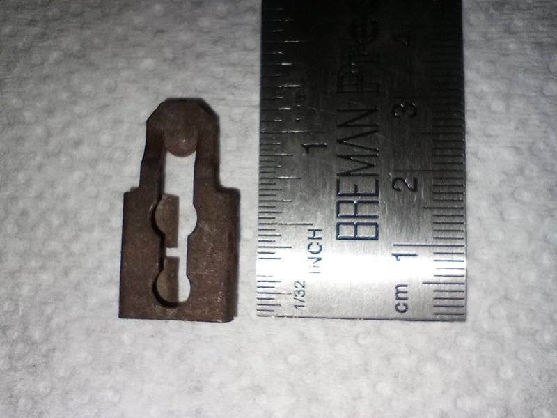

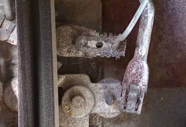

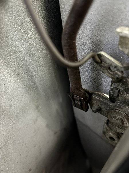

Here are some pics. The first two of just the clip were pulled from a 66 or 67 Charger. Not sure of the year because i only have the doors. The other two pics are from inside the door of my 67 Coronet parts car. The clips are a little bit different but i'm assuming they're functionally the same even though they look slightly different.
