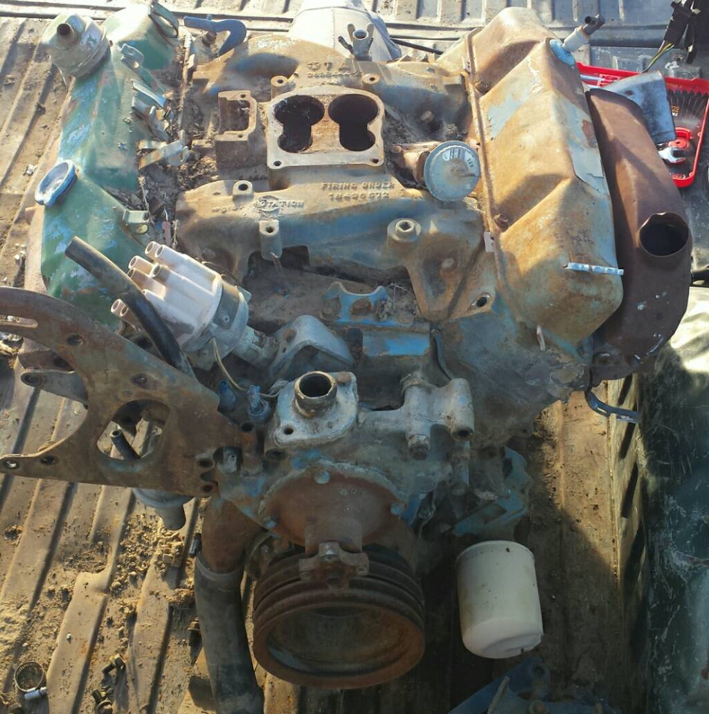

I'm not doing a stock style 440, as I'm definitly going to be making more power and removing the emissions stuff. The year of my 440 is unknown, but I do know that it's a later cast crank 440. Here's a picture:
So what is the difference between the power steering pumps and hoses between big and small block cars? I noticed that the big block one has cooling fins, whil my current small block one doesn't.
