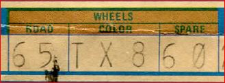

I currently have no spare tire with my car and would like to purchase a factory original. The broadcast sheet says spare tire 60. It originally came with 14 x 6 road wheels, but not sure if the spare was also a road wheel rim or a plain black type. Any help would be appreciated.
Thanks
Jason

The spare would be a plain steel wheel painted black, with more than likely a F70 15 tire.

F70 14 tire...
The 65 is for a road wheel PN#3580065, 1972-74 B-body, 14x6.0 Road Wheel Class 2
The TX8 is the color of the spare wheel (the best I can find says black, even though TX9 is normally black)
Ther 60 is for the spare wheel PN#3580060 (or #3621954), 1972-74 B-body, 14x6.0 stamped steel wheel
