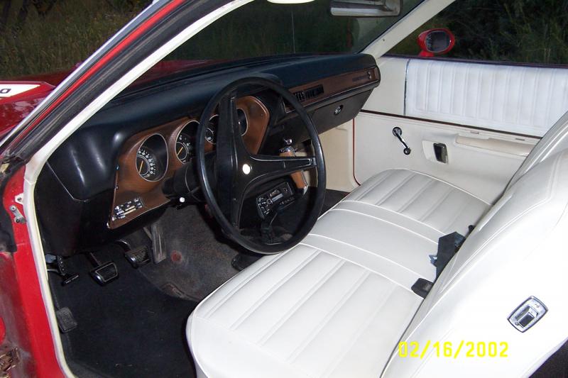

Does anyone here have a Charger or Satellite with bench seats and a 4 speed? Im looking into doing a 4 speed conversion, but really like the idea of keeping the bench
Pictures are much appreciated :hello2:
I might be able to help you if you have any questions. I am going to do the same conversion to my 73 Road Runner
Here is one I used to own. Sorry not the best shot.
Need the short hump and the dog bone shifter mount.

here is my link i just did it to my 71 ssp
http://www.forbbodiesonly.com/moparforum/showthread.php?t=27567
here is my link i just did it to my 71 ssp .. you use the forward shifter location on your tranny with the 6 inch set back . it's for the bench seat or buckets with the buddy seat.. I used the tranny from a 69 road runner and they only have the front shifter location so thats the rout i had to use.
That is simply the COOLEST!!!! looking interior. That is so bad to the bone! That is exactly what I was talking about! If anyone has any other pictures Id love to see them. Khaley 71 and rog allen I will be sure to read about and follow your projects
