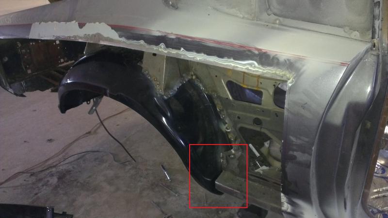

I had to replace both sides of my charger and the wheelhouses fit more less perfect. Only problem i had was on the passenger side where the wheelhouse meets the rocker panel, there was a small gap of maybe a 1/2 cm. If you want i can load a pic to show you what i mean.
Yeah if you don't mind load a picture please. Thanks
No problem. If you look in the marked area you will see the gap.
The gap wasn't hard to fix

so thats the ONLY modification needed to fit a 71/72 onto a 73/74 ?
pic is not really clear but gives an idea at least
I know the pic could be better, it was made with my old samsung cellphone. :sad11:
Yeah that was the only modification i made to the wheelhouses, otherwise it fit perfect.
