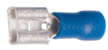

It could be used a terminal like this
Is not exactly the one used on factory but works. I can't find a pic of the original one. Original one is not spring loaded, but like the original ends are not curved to inside, but flat.
Those female spade type connectors (very common and general in electrical wiring) are what is used on single wire oil pressure sending units and switches. They just slide on the tip like the picture above. I just changed my pressure sending switch which has this connector on a gray wire (225 Slant Six).
Thanks, guys. I did wind up just slipping the clip thing over the top and the gauge works. Seems like a really shoddy way to wire it, to be completely honest. There's no safety mechanism to keep it from sliding or vibrating off and grounding out. Pure genius. Either way, it works now, so that's what matters.
