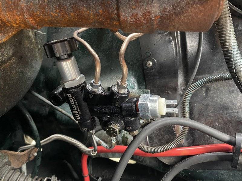

I ended up using a Wilwood combination valve ( proportioning valve) and it’s been working fine. Had to make new lines off from my old master cylinder but used all the other lines, just bent them up. I also had to buy longer lug studs due to the rotor taking up all the thread
Looks good! It sure looks like the lines from the master cylinder to the proportioning valve are copper tubing. If so, this won't hold the pressure and these need to be steel or stainless steel.
