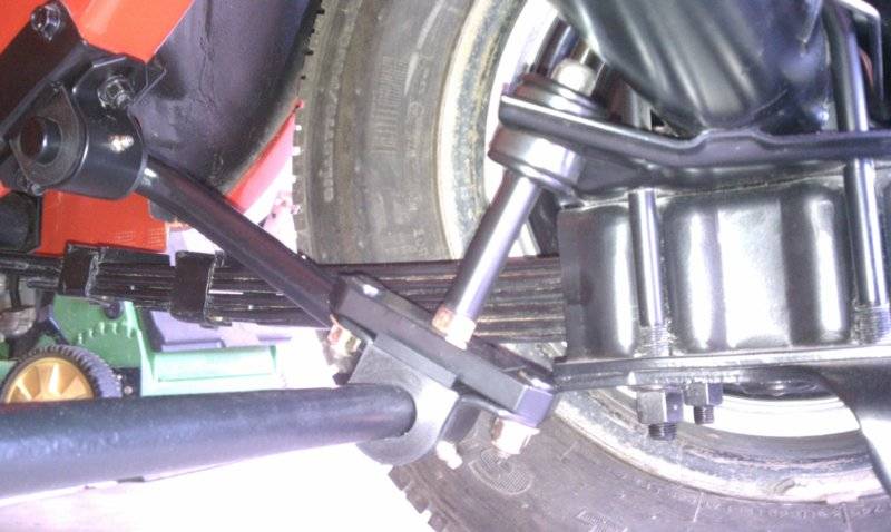

Will this work, my 73 RR
That looks like an after market set up on the road runner? where did you find that?
I thought I saw a picture with the sway bar bracket on the bottom of the u bolts and axel
The sway bar and sway bar plates are original, but the bushings and links are from firm feel, however, I have to shim them to get them to grab the bar, not sure why, but I have talked to them many times, and their test sway bar apparently doesn't have the same problem, so I would like to eventually find factory ones to put back on if I could ever find a set.

I need to post a picture or 2 of the linkage a person made from Georgia that I'll be installing at a later date. They look very similar to the ones in the pictures. Haven't found replacement rubber bushings for the factory linkage yet.

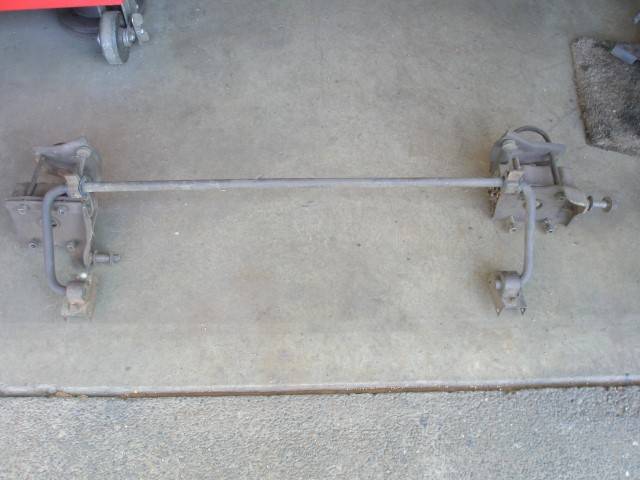

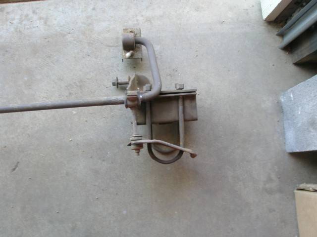

Mines are round, not elongated, and didn't got a problem installing them. Tighter fit but still fit without problems. I guess laters got elongated. Sometimes some pieces must be assemblied loosen then tight here and there step by step piece by piece
U bushing to frame and Square rubber bushings on bar itself to rods must be pretty much similar to some other one. The bushings on top of rod links are exactly the same to the front sway bar rod links to K member
71-72 had round holes, 73 were elongated and a larger center hole for the iso bushings
well, 72s are way diff plates ( there is no 71s ), flat to fit straight over springs and not over isolators...they are all round
73 and lates are shaped to fit into isolators.
73 and lates are available in both, round and elongated. I have round on my 74, althought my setup was a recent add on ( used ). We have discussed on 3rd gen board sometime in the past about what it was the year for round and which one for eliongated but I can't recall.
please check the link I posted
there is no way to fit a 72 plate into a 73 and late setup.
I was making a simple statement that the brackets will fit the 71-72 axle configuration, not stating which year the brackets are from, sorry for that confusion. I was also saying that only the later years have elongated holes, no 71-72 arrangement. I have both versions of the 73-74 and the 72. Your link is a very complete description.

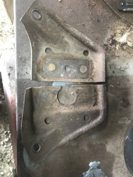

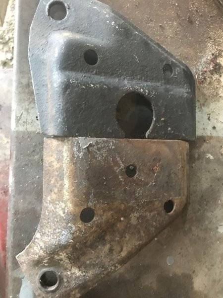

771CA8BC-5CFB-4F04-B194-0B963374B06F.jpeg 13FC7E12-DA4F-4240-A931-A4C5A651F1C4.jpeg
My RR is a Oct. 72 built car. The original swaybar plates have the elongated bolt holes but drivers side is bent and part of it is ripped so I switched to the other set I have that gave me all the trouble, they did not have elongated holes. I also have a set of 72's, those are a lot different as shown in the pictures above.
