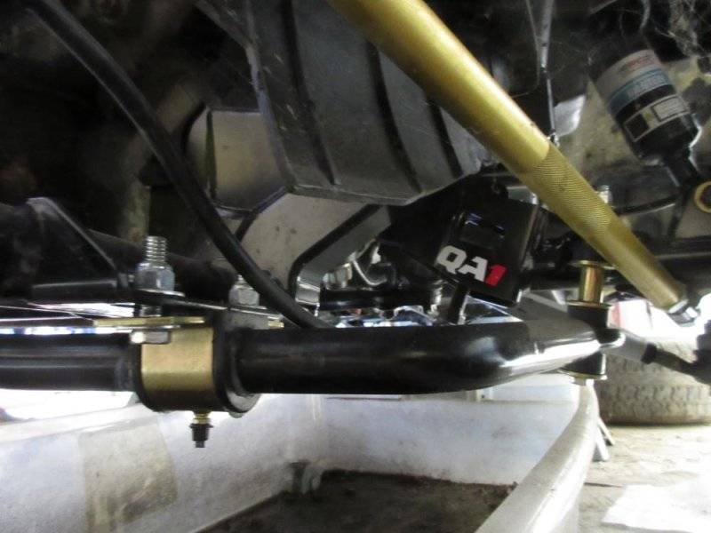

My QA1 bar is mounted on the QA1 K member. No way it goes through the K member. I tried it - it hits the strut bars, and the splash guards are inside of the strut bars (did not have the splash guards installed until later).

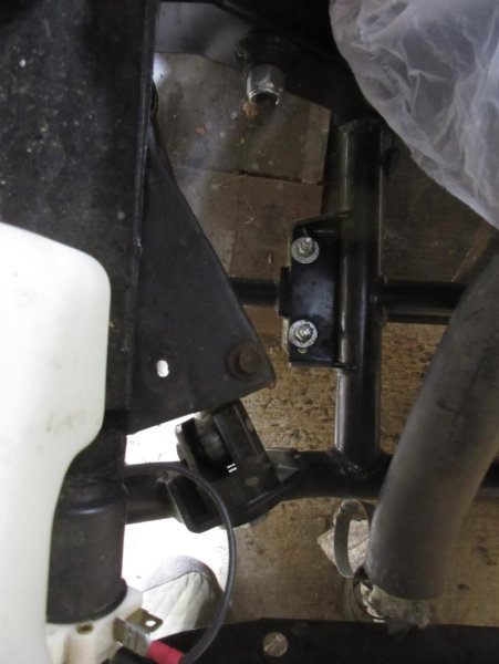

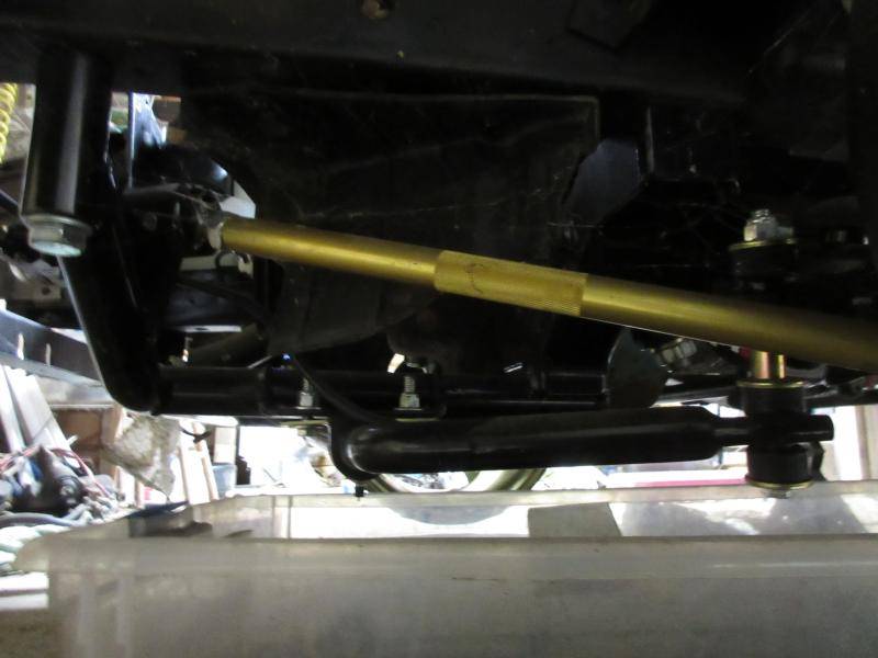

And some pics of the QA1 bar and K member in my Charger (which is on jack stands, the front suspension is hanging at the limit of its downward travel)

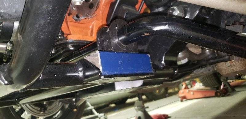

And here is the Hotchkis bar mounted through the QA1 Kmember of one of our FBBO user's 2nd gen Charger -
It looks like the QA1 bar is a couple inches wider than the above Hotchkis bar -
I don't think the splash shields are mounted on the Hotchkis equipped car - maybe the Hotchkis bar won't clear them either?
The factory bar is under the splash guards, but it appears to be a couple inches higher than the QA1 bar. "Appears." Is it really?
Will any of the bars clear the splash guards when mounted through the QA1 K member?
It's really a shame the QA1 bar is so wide, as it's a nice piece otherwise and more affordable than the other options. I hate not being able to use it, but I don't see any way to.
