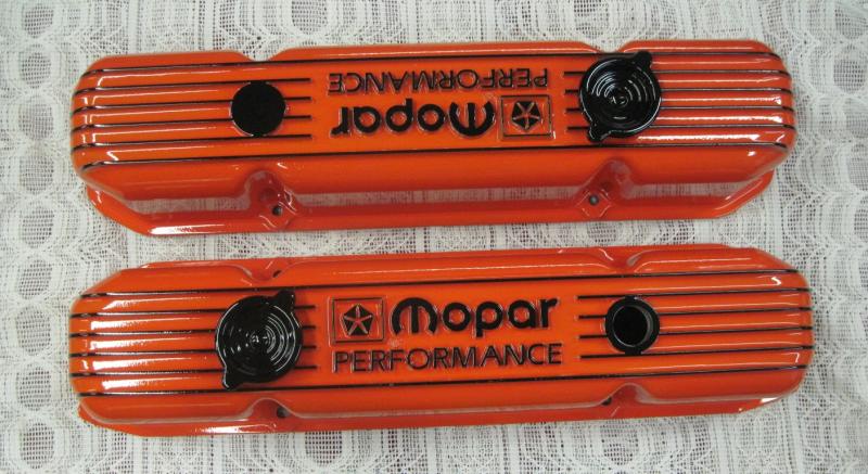

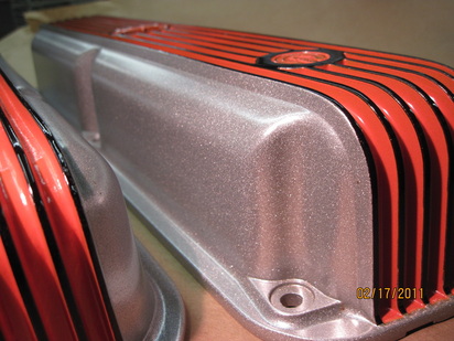

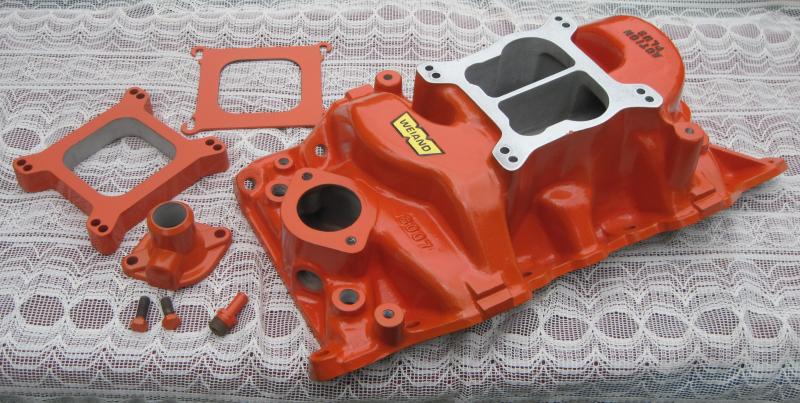

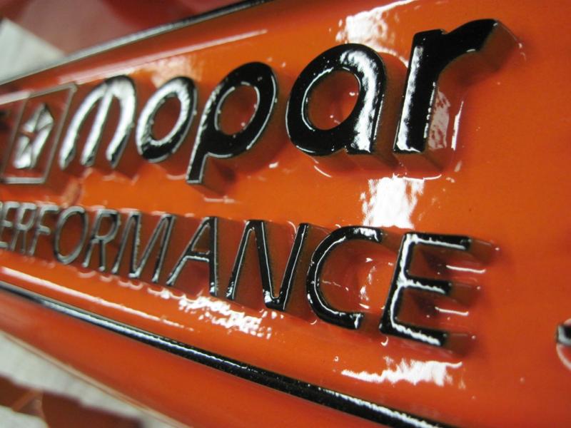

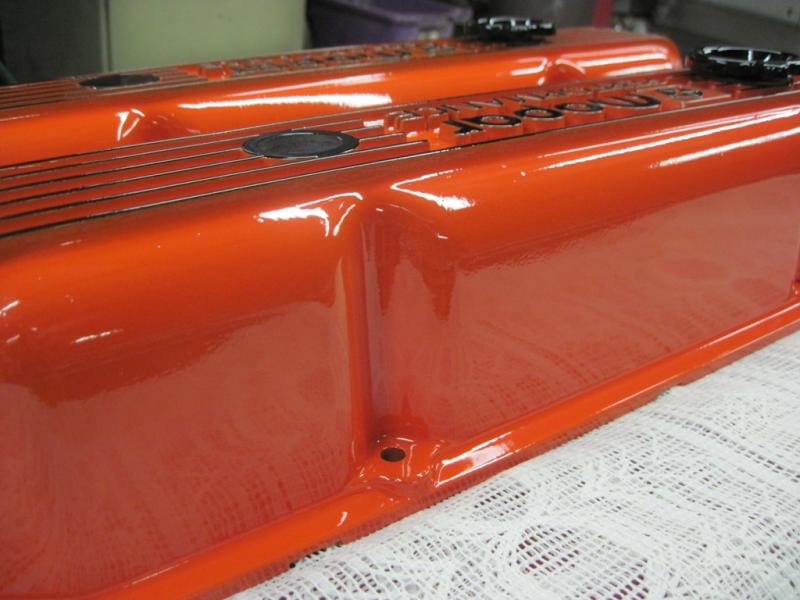

This is my powder supplier's Hemi Orange ... smooth, glossy and a VERY nice match to the factory paint.
It's one of my most popular colors around here. :D
Beautiful looking parts and love the added lace type drop cloth they sit on, Nice touch of classy looks! :)
Thank you Ron! (Truth be told, that's an old curtain LOL!!!) I have a few "backers" I use for my formal website photo spreads depending on what color the parts are that I'm showing off. Now that you pointed it out, it's funny that my dark blue and burgundy cloths get summarily rejected for Hemi Orange since they clash too much. :D

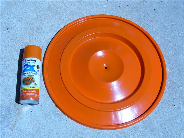

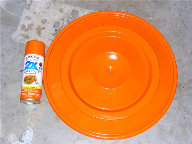

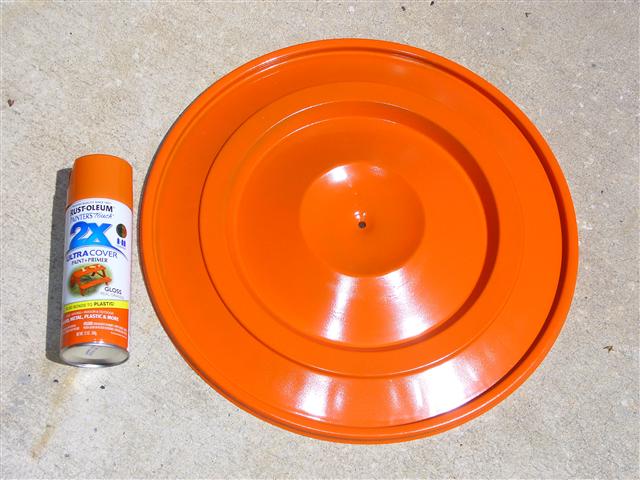

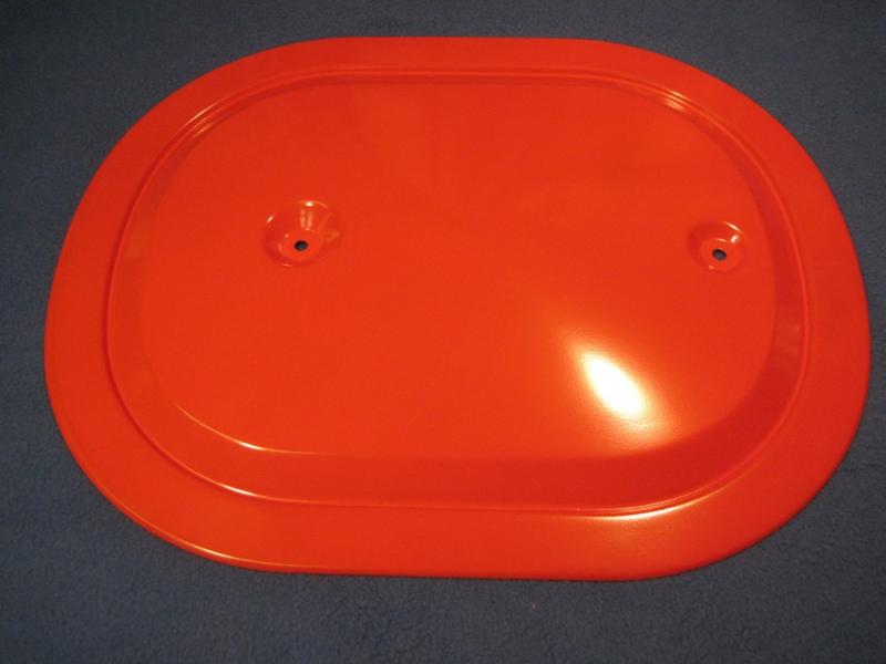

I went through the same research a few weeks back - Totally Auto would be the source but I'm on a tight budget. Found a recommendation on one site for Rustoleum Safety Orange , couldn't find it anywhere except on line - but did find this orange at Homey Depot which really looked close
P1100173 (Small).JPGP1100174 (Small).JPGP1100175 (Small).JPG.
This is without flash outdoors , with flash outdoors , and with flash indoors so take it for what it's worth. If I determine it's off too far from original (like I give a flip what anyone says) I'll repaint at a later date , looks pretty darn close to me !
Will scuff, clear coat and decal later this week.

Buy a can of that Rustoleum orange at Home Depot and see what you think - I don't have anything to compare it to but a few chips of old paint and it's really close .... you could always take it back. Totally Auto's is 25 bucks (!) a can plus shipping and one can may or may not be enough (?) If you need it 100% dead nuts match (if there's an original within 25 feet to compare it to !), then you may want to go that route ....... your call
