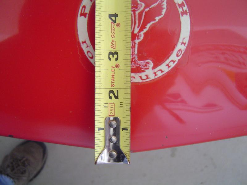

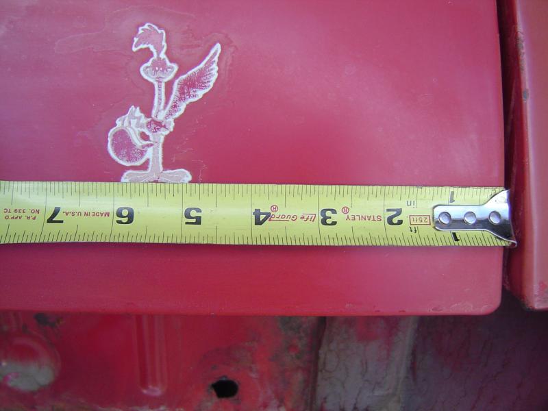

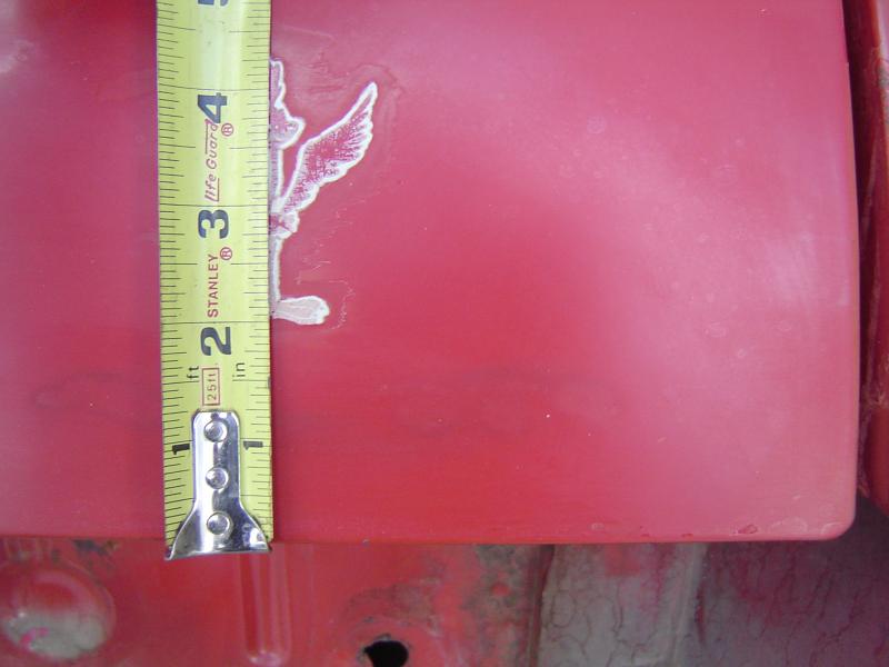

i need to put my header panel and trunk lid decals on my 73 roadrunner. can anyone help with proper locations of the decals any good pics and measurements. also need info on metal emblem on trunk lid location below standing bird decal.
Here you go. I believe the "Road runner" under the standing bird on the trunk should have the 'r' in runner centered under the line between the standing birds feet.
