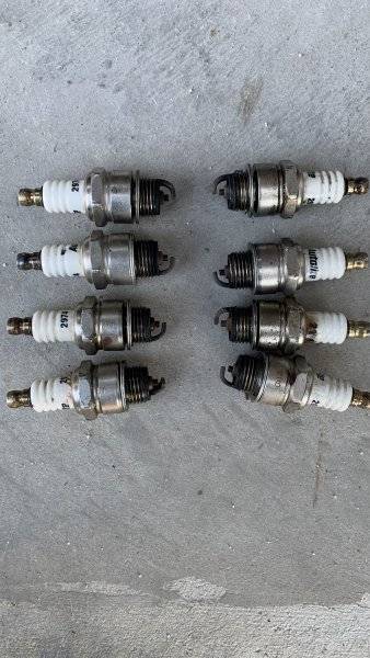

The spark plugs look a bit rich to me.

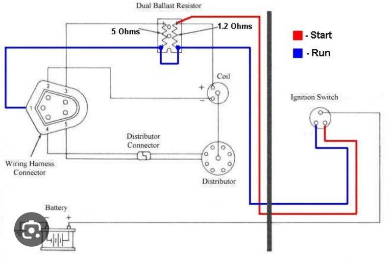

If you think this is a wiring issue run a hot wire to the ballast resister and see if the miss goes away. There are two schematics depending which ballast you have. Posted is the ballast w 4 connections. Also might check the air gap on the distributor. Both initial and advanced. Its suppose to be .008. Unfortunately a lot of new parts arent what they should be for quality.
Thank you for your reply! I believe I have tried that in the past but I’ll give it another shot. Right now I’m having an issue with even getting power out of the bulkhead. It must be the main power supply wire, normally the fuseable link, at the bulkhead. Just very difficult for me to get in there with my hands being messed up. I’m going to work on it some today, we’ll see!
