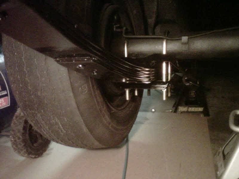

You don't have to do anything to the replacement springs but bolt them in. You should always use new U-bolts with new springs. The only thing different is the idolaters which I like myself. However; if you don't want to keep them all you need is 72 and older U-bolts. I run high arch XHD springs with idolaters, 2"lowering blocks and 2 degree pinon angle shims om my 73 Charger.

heres a pic of the setup i think. looks like i'll be going with this. 70 bucks for adaptor set and new u bolts and thats it.
I spoke with Gary about that setup...he said it had everything except the u-bolts. I ended up getting a 71 Runner rear and the older shock plates, so I won't need this setup. I got both my solid k-frame and torsion bar mounts from Gary at Solidbushings.com, and I am very, very happy with the quality and price of the product.
