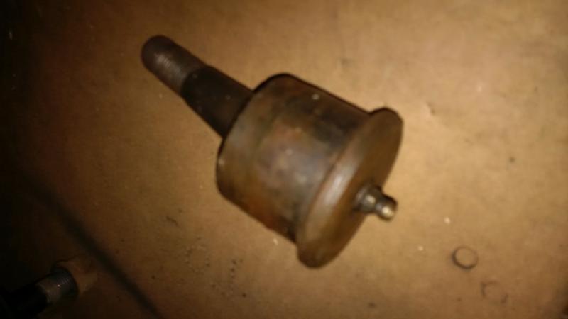

You pressed the old ones out? Did they have hex collars?
Yes I pressed the old ones out, they are not the threaded type and have a round collar. I didn't know that they changed mid year, thanks for the info. I will take and post some pictures of the control arm showing the threads.

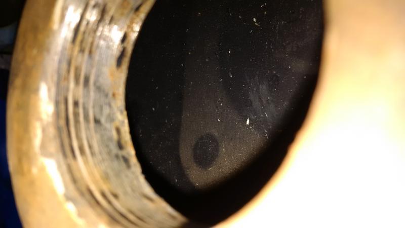

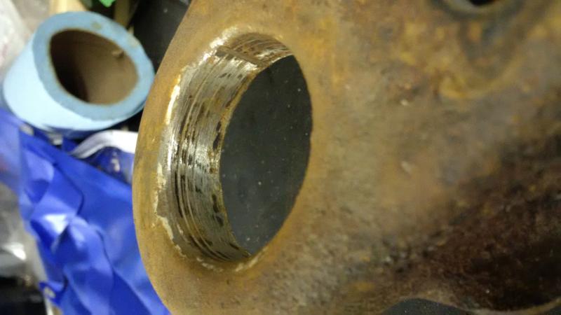

Here are pictures of the ball joint and the threads on the control arm, when they changed to press in did they just grind down the threads on the control arm?

Are those threads or just parallel circles?
If they're threads, someone pressed in the BJ and ruined them.
Yep, about 1 full turn by hand. Any looser and control arm crack is suspect, and tighter and cross thread possible.
They are threads, I was able to run around a few times and they do thread down the hole.
