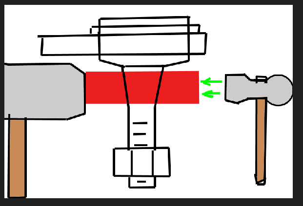

Screw the ball joint back in so you don’t damage the threads. Take that hammer in the photo and wack the hell out of the area marked with green arrow. It will drop right out

1. Loosen nut on upper balljoint under upper spindle mount. Take it out about 5 or 6 turns, enough that you can see a 3 or 4 thread gap between nut and spindle
2. Hit spindle with large hammer where it is marked by a green arrow above. The pressure of the torsion bar will separate it easily.
3. Next, repeat with lower ball joint.
It separates easily but you will need to pull down on the spindle or drum assembly to see it is separated because the torsion bar presses down on it.
4. Take the pressure off of the torsion bar by unscrewing the adjusting bolt out until the torsion bar no longer puts force onto it.
5. Remove upper and lower ball joint nuts, tie rod nut and remove the spindle and brake assembly.
6. Unscrew upper ball joint.

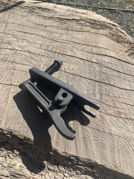

Harbor freight tool I use alot- get the pitman arm puller too.

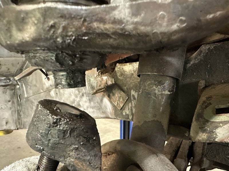

Okay, I figured that I needed to replace my UCAs since you all agreed that they were beat up (and I couldn't remove the large top nut holding the ball joint anyway). I tried your suggestions to remove the knuckle and spindle and gave up. Since I was replacing the UCA, I figured I'd cut the ball joint (see picture) and simply hammer out the protruding end on my workbench. IT WILL NOT COME OUT and I've hit it as hard as I could. I even drilled out the center thinking it might provide a little more give; no luck. Of course, in the process, I'm guessing that I've damaged the knuckle so now I'm looking at replacing the knuckle/spindle.
So, here I am, back for ideas. Since I'm now replacing my UCAs and knuckles/spindles -- and I'm thinking of going with front disc brakes -- what advice do you have for me? @Runner 68 , I like your look but I'm guessing the cost would essentially double the car's value; still, my birthday's coming up.... I'm looking to build a driver that I can feel safe in.
Take the spindle off. You have to anyway.
cut the ball joint stud with the mushroomed stud even with the spindle with a sawzall.
Now turn it upside down and support the knuckle. Get some help or a big vice.
If you have a torch heat around the stud left in the tapered hole. Heat the knuckle. NOT THE STUD. Get it as hot as you can. Get the grease and rubber off as much as possible. It will catch fire.
Get a long bolt or punch close to but not as big as the ball joint stud and with a big hammer smack that sucker. Keep the punch or bolt as flat as possible/perpendicular.
You could even try an air hammer if you have the right flat tool to use. Don’t want to spread the stud in the hole like a center punch!
