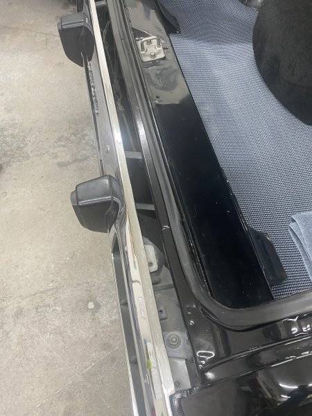

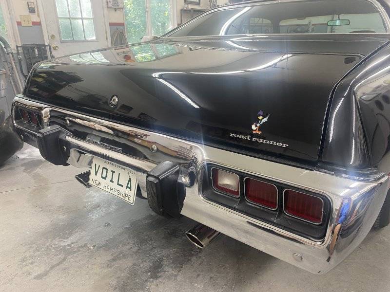

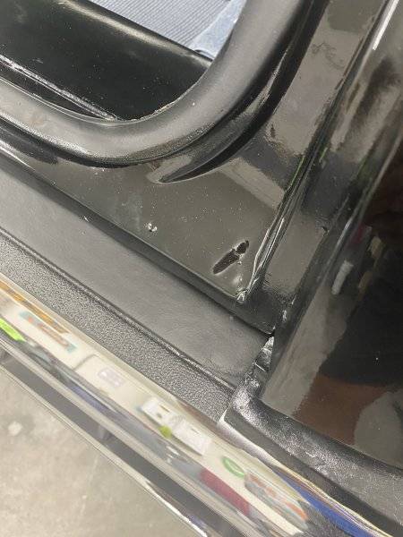

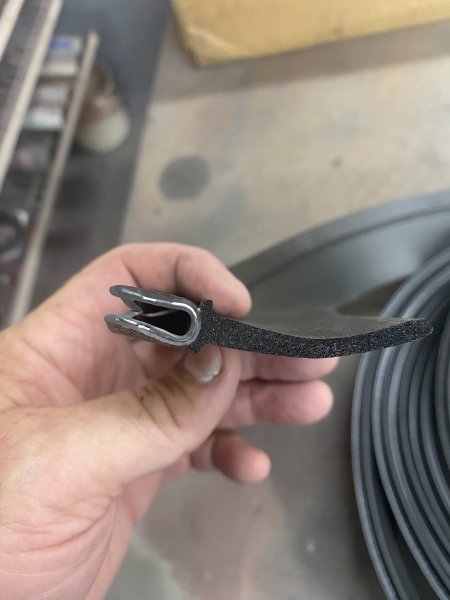

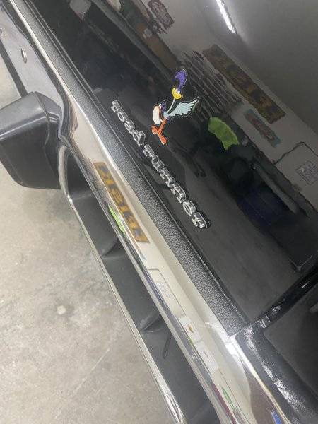

After looking for over a year for the bumper filler for my 73 RR I found a perfect substitute. This is a product for campers/RV's and it works and looks great. I had to buy 25 ft so I have enough for three more cars....
If someone wants some I'll take $50 plus shipping for one car. It won't work on the side panels....just the straight back part....good luck on the sides, mine look fairly good.
Nice.
From the factory, the center filler extended under the corner fillers about 1/2 inch.
There is a molded step in the corner filler to accept this.
