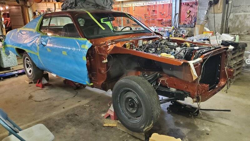

Hi everyone,
I'm getting ready to put the front end on our 73 Satellite and I was wondering if someone that had put theirs together could tell me some kind of order to help me from taking things off and on because I didn't know what order to put them on. I never took it apart so I don't have that to go by. Trying to keep from damaging paint and body parts. The front fenders, splash shields, grille, front bumper, ac condenser, front valance, etc. I posted a picture of the car as it sets now to show for sure where I'm at. I would appreciate any help anyone could give.
Thanks
Fenders, header, grill, lower valance, bumper if the inner fender splash guards aren't already on, those would go on 1st. Hope that helps.
