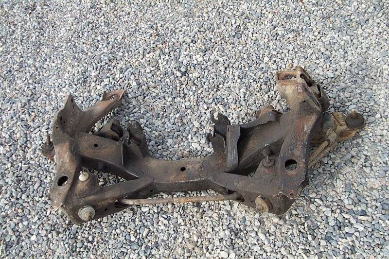

Hey....does anyone have a picture of their '73 / '74 LCA that shows where the sway bar mount is located?

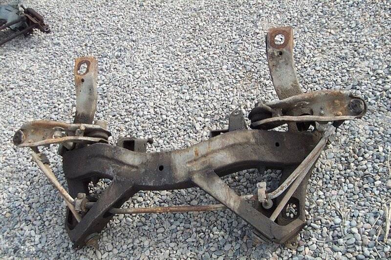

I can assist when my k frame gets back here . If you can't find one in the week msg me it should be here by next weekend

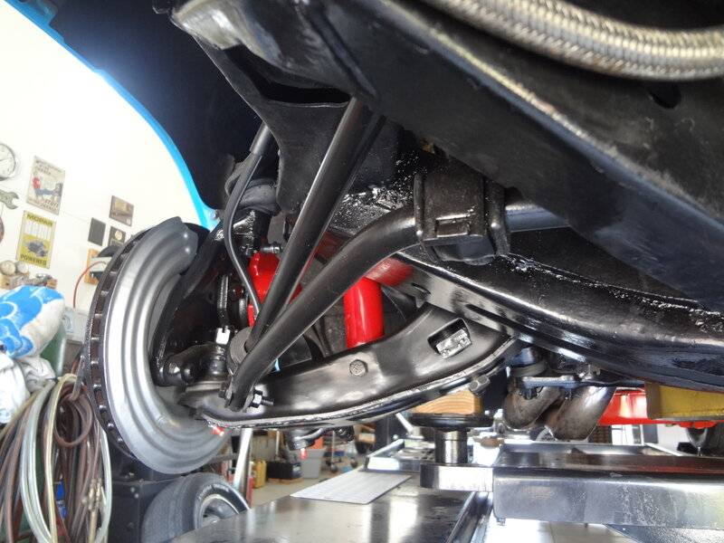

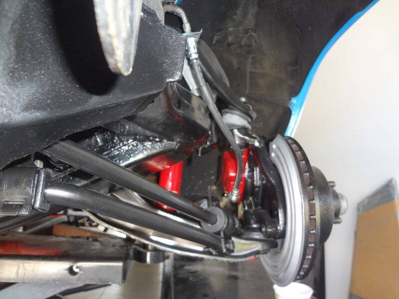

Hope these help

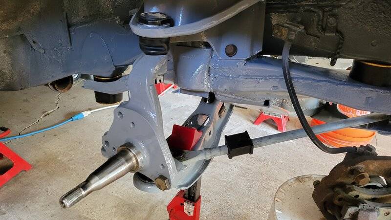

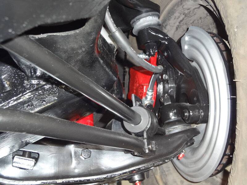

The ends of the bar attach to the strut rods, right?
Oh, wait....maybe I do have the correct bar. I didn't know they could attach directly to the strut rod with a bushing! Thanks!
Yes,
that's how they attach, Clamp around the bushing on the strut rod. Bolt through the hole in the torsion bar end and clamp.
Yes,

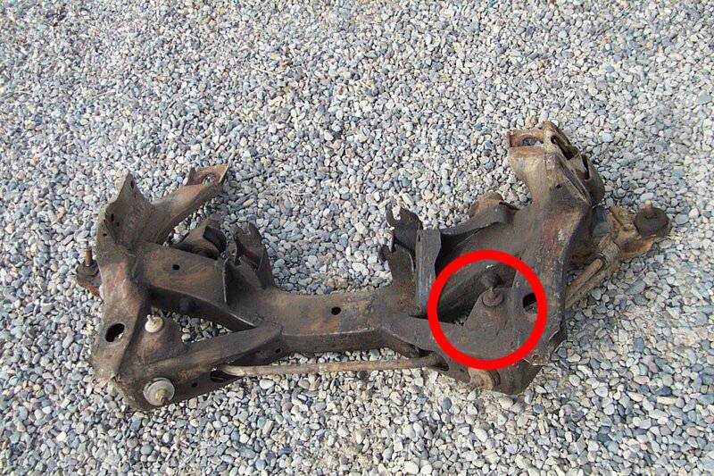

Looks like my k-frame does not have these gussets (pictured below) that hold the support for the sway bar...
Looks like my k-frame does not have these gussets that hold the support for the sway bar...
I believe they are reproduced by some one. Did you check with ADDCO or PST. of course you will have to weld them in. For that matter you probably could make your own or find a "K" member in a bone yard that you could cut out.
1973/74s "B" Body and 1975-79 Cordobas have the same design "K" members

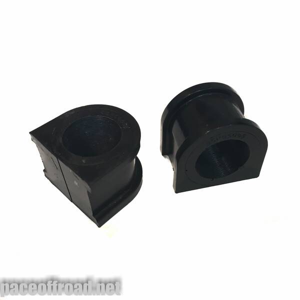

I get the feeling these sway bar isolator bushings were made for aftermarket strut rods? The stock rods have a lip at the threaded end that the inner diameter of the rubber bushing must somehow get past, in order to slide it down where it belongs.
And I assume it's probably not a good idea to split the rubber bushing in order to get it on the strut rod?
I get the feeling these isolator bushings were made for aftermarket strut rods. The stock rods have a lip at the threaded end that the bushing must somehow get past? And it's probably not a good idea to split the rubber bushing in order to get it on the strut rod.
Heat the rubber bushing in boiling water, apply grease to the strut and they will slip over the lip. Wear gloves those bushings will be hot. I don't remember if I slipped the bushing over the strut rod end that bolts to the LCA. That is flattened out and maybe easier to get the bushing over.

Somewhat little known fact that 73 and up cars built without sway bars didn't come with the mount ears welded to the K frames.

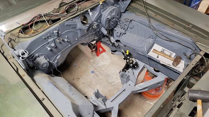

The good news is that my engine is currently out of the car, as I am rebuilding the entire front suspension. So, easier access to fab and weld...
