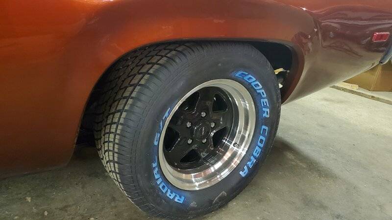

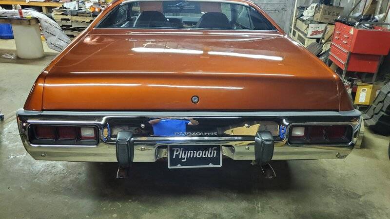

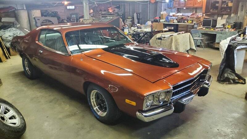

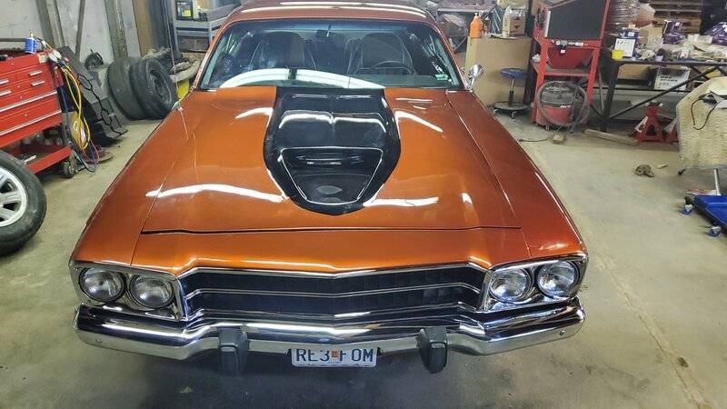

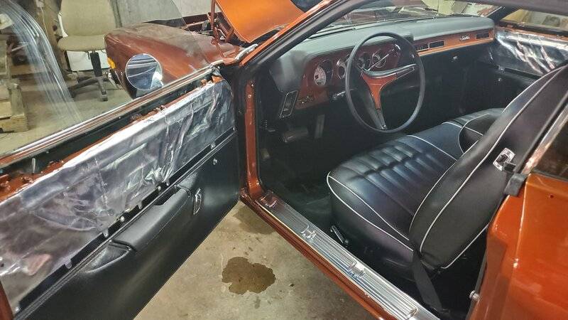

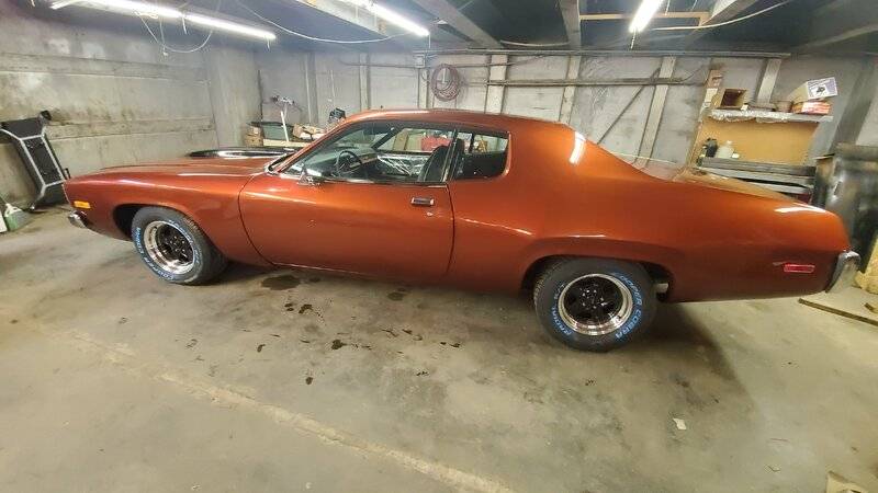

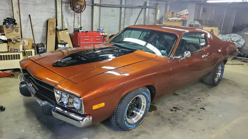

We are still waiting on the vinyl top and some door panels but it is drivable. After the vinyl top gets here we can put the rest of the trim on. Going to alignment shop Monday and then it can go on a real test drive. It's been a 5 year project, we can't wait to drive this Satellite. 20200814_155013.jpg
Like the color! Same as my first 3rd gen Charger.
You have a beautiful car! I love that hood scoop. Is that off a Charger? I love to see these cars customized while still keeping that close to original look.
Also those back tires have some meat on them! :thumbsup:

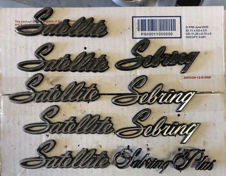

Need some emblems? I have several!

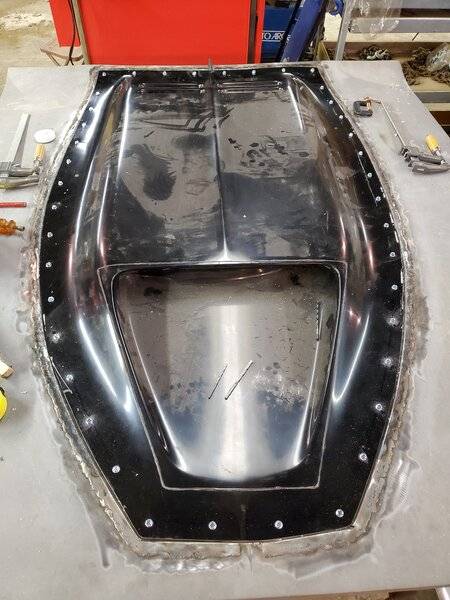

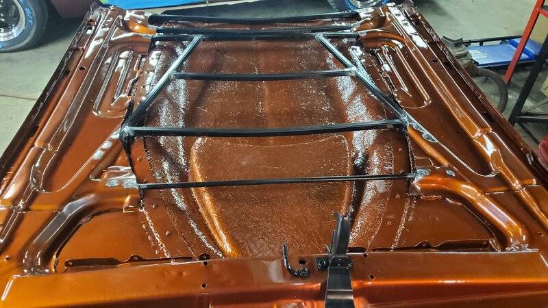

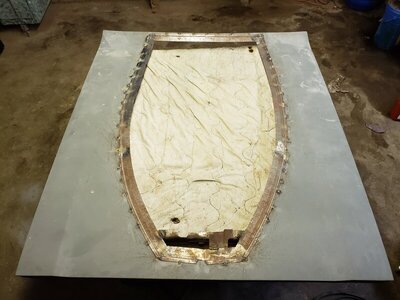

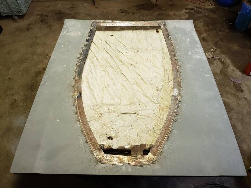

Actually it is a cuda hood scoop, the guy we bought it from had a friend with a fiberglass shop and he had him make him a cuda hood thinking that it would fit. After he found out that it didn't fit he cut the hood and was going to just put it in the original hood. We wasn't going to finish what he started because he cut all the bracing out of the hood. After a lot of thought we decided it would be an eye catcher and decided to give it a try. It came out better than we figured it would. Everyone says it will crack and look like crap before long and if it does we have another hood off a 74 painted and ready to put on. I will post some photos of our bracing idea to try to make it work. The photos are on my phone but I will try to figure out how to get them on here.
