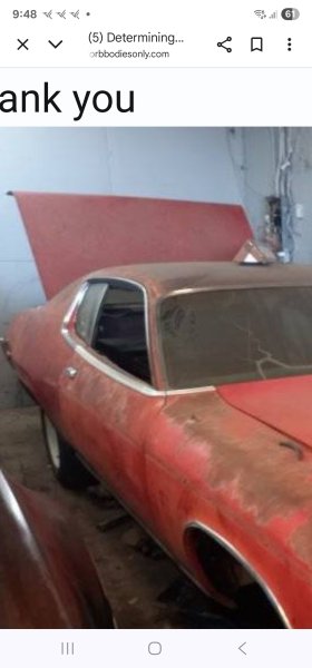

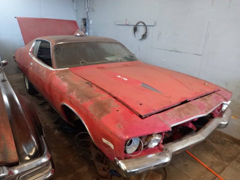

Yup shouldn't be hard. J400 on the pad with a date not long before the build date
Which car is picture? The roadrunner or the satellite? Bonus if RR hood with satellite
Headlight Bezels and the Grill are gonna be hard to find in good shape.
I had a 74 Sebring Plus for a while, 400, full gages, buckets console, loaded but needed full resto and I didn't have the time then.
Also what's the VIN code?
P is 400-4
M is 400-2
400-2 is much more common and not as desirable.
Still a factory big block though.
Notice the hood in the pic does not have the trim that matches the "belt" trim on the fenders, doors and quarters.

Southbranch, moparvinson, and RR Fan Dan, this is the satellite in the photo. The hood was one reason for buying the car. My son’s hood was in good shape, but this one is better. It also had a few side interior parts we needed, and included was a very nice instrument cluster with mechanical gauges and a 150MPH speedometer. It was an auto with no seats, but I will have to go back and look at the floor to see if it had buckets or not. I had planned on using the entire floor pan, but when I found the floor pan at AMD I went with it. Then as I was prepping to cut the rear step wells out, I came across some new ones on eBay and they were a perfect fit for us.
