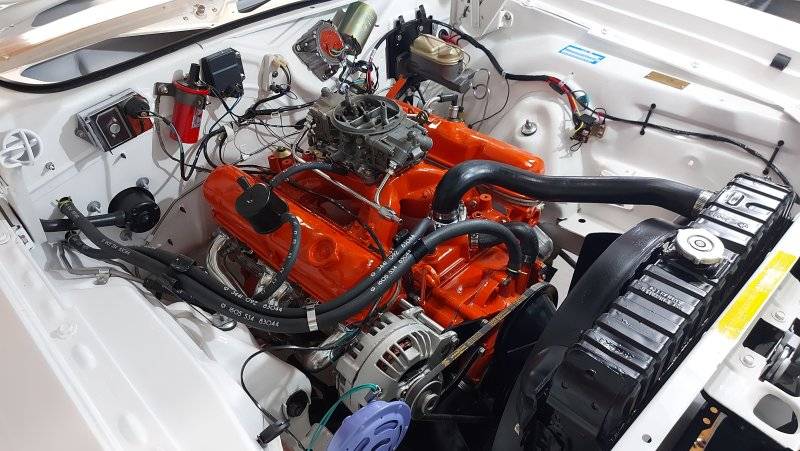

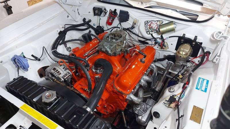

Will a Edelbrock RPM air-gap on a La 360 have enough hood clearance.
I have the RPM air-gap intake on my 360 in my 71 Runner.
BUT I had to remove 1/2" from the bottom of my Air Grabber oval air cleaner to clear the underside of the hood.
You can see what I did here.
The pics are about halfway down.
I just realized that you will have a different engine mount set-up as yours has the iso-clamp set-up with the cradle style engine mounts like I had in my 76 Roadrunner.
Those may or may not sit the engine higher or lower in the engine bay.
