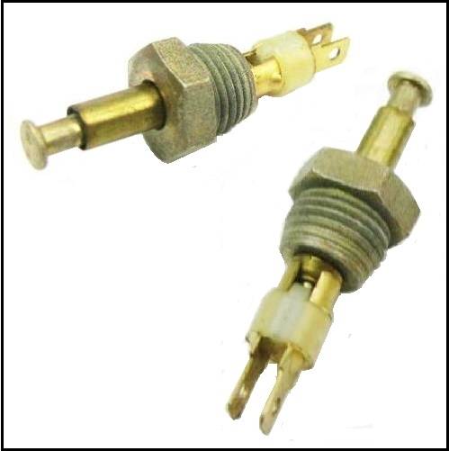

Threads of the door jamb... LOL. You must be a beanhead to figure this out then.
A you mean the switch.... So, loosen the door jamb 'switch' clean both the switch and door thread and bolt it back in.
Spring-loaded plunger switches are prone to water ingress, thus rust issues.
The threads on both the bodywork and the switch itself grow rust over time.
Remove switch, clean threads on it plus the bodywork threads, spray some CRC or similar 'Gypsy tears' into the switch, plunge a few times, and clean the contact area on the ends, then re-install.

The door jam switch on 74s gets two wires (so, two it has two prongs). One is yellow for the dome light, the other one is black to handle all the driver convenience warning signals.
If the prong feeding the black wire is maybe some loosen ( it’s posible since is hold by a nylon/plastic ring getting damaged) could be getting grounded accidentally still with door closed so will feed the lights on warning signal as far lights are on of course.

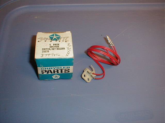

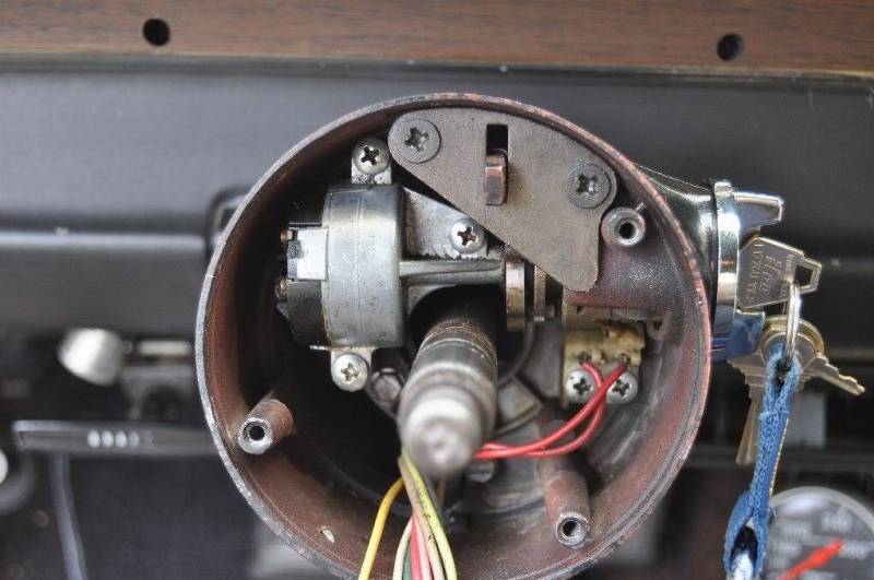

this same ground reachs the ign switch key in sensor switch inside the column. But, this switch could be damaged, or maybe disconected down the column. This switch uses two 18 gauge red wires coming out from column and conecting to two black wires on ign switch plug.
if both switches are closed, which would mean door is open and key is IN, the buzzer will buzz
I hope sounds clear
If the centre contact of the switch for the two prongs in conical in shape, a ridge can form on the cone surface - this would give an intermittent contact closure.
The switch needs to removed and examined closely......if badly worn on the cone-shaped surface, a new switch should be installed. Remember these switches are not designed to last forever. Chrysler ...along with other manufacturers at the time didn't expect their cars to on the road 50+ years later.

Ign key in switch/sensor in place. A lever coming out from key cylinder activates this switch when key is inserted
Thanks for your advice on the lights on buzzer. It works now.
The key buzzer does not work yet, so I have to get the steering wheel off then to figure out what's happening with the lever.
Any additional tips are welcome! Do I need special tools?
Manually operating the plunger works fine for both the lights or buzzer. But I the plunger is a bit short, so when I close the door the lights go off, but strangely enough the buzzer keeps buzzing. I loosened the switch a bit so the plunger comes a bit toward the door. Now it works fine.
