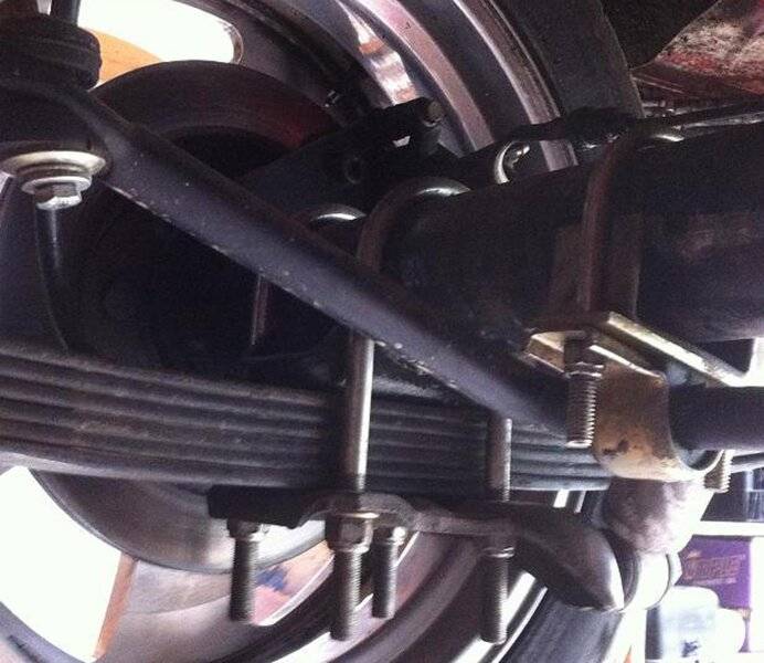

how many pics do you want to show that ?
My car was assembled in Vzla, BUT with parts from USA. just around 15% of the parts of Mopars assembled in Vzla were made with local made parts but still with original casts
That is a surprise! I'd like to see a clearer picture of just the housing. The center hole in the spring pad is a LOT larger in an ISO car. It is one way to immediately identify a 1973 and later axle.
I Know it got a larger hole for the iso assembly. My 74 got 8.75" axle with the iso clamp assembly. I replaced my springs with 71/72 which uses 5/16" guide stud and had to remove it, drill the hole for the larger 3/8" guide stud 73 and lates uses and longer to accept the bushings for the isolation pads, then the clamps with the big provision and the axle spring pad with the matching hole for the upper clamp provision.

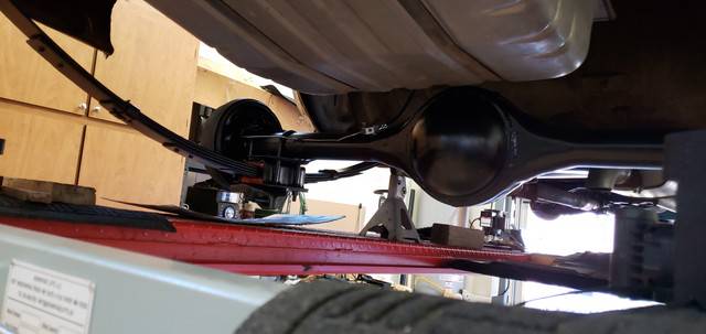

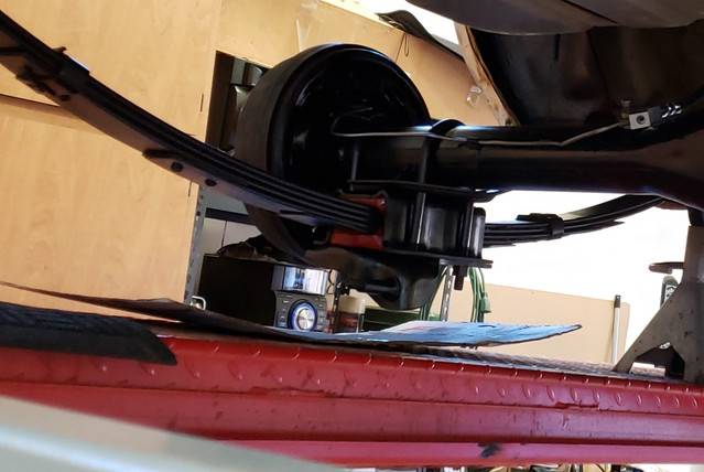

This is the rear axle in the 73 Rally 400 4 speed car I currently own. Red poly isolators firm it up nicely.
