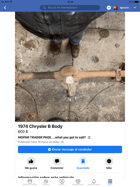

Rallyes ( and I guess RRs ) did as standard, no matter the axle you got.They didn't all get sway bars. Ya got 6 leaves
That is a surprise! I'd like to see a clearer picture of just the housing. The center hole in the spring pad is a LOT larger in an ISO car. It is one way to immediately identify a 1973 and later axle.
