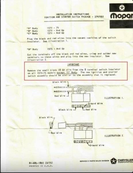

If you have a replacement ignition switch, there is an 18ga black wire that has to be removed on some applications. Not sure if that’s your issue, but it might be worth checking.
The small black wire on replace later ignition switches would not be involved with starting. Assuming a stock ’74 ignition system, as Nacho mentions, disconnect the ballast resistor leads and verify +12v on the brown wire (Ign2) while cranking. This symptom normally points to a failure of one of the resistors in the dual ballast resistor. Do a continuity check on both resistors.
