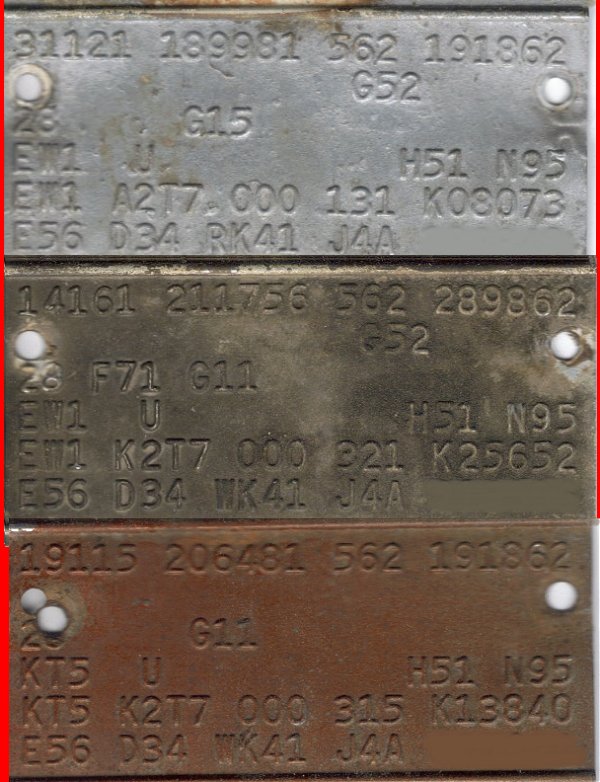

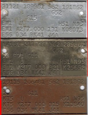

I don't seem to have any '74 police cars with the E58 engine. I do have police cars with the E56 so either the '74 E58 was optional on 'police cars' or the E58 was not exclusive to police cars.
