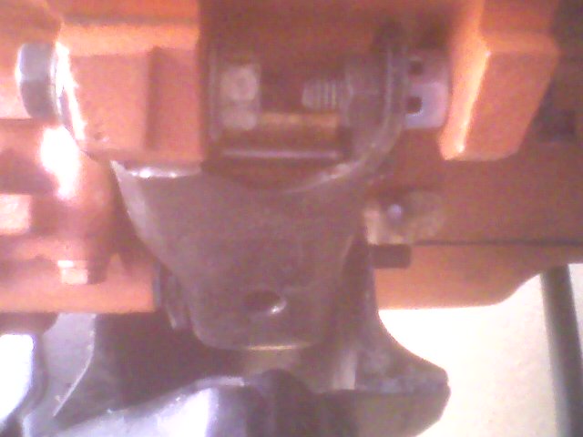

I have hedman long tube headers on my 440 in my 74 charger that has a small block K member. I had to put one little ding in the #3 tube to clear the steering box. that was it, they do not interfere with anything. I probably didn't even have to put that one in , but I wanted a little re-assurance. I did not use conversion mounts. I used BB motor mounts and did a little cutting , mounted them in front of the bosses and they sat right down in the K member. the engine does not sit high in the K frame. it sits right where it should be, confirmed by another BB car. I am using SB 77 charger torsion bars which are .96 thick. and are plenty stiff for the 440. I accomplished this by mounting up the trans first and then working each mount to fit. to my knowledge only the 73 had the big giant hole on the passenger side engine compartment. the 440 in my 74 clears everything, with headers. I am using a 699 oil pan.
I had a 318 74 with a 383 swapped into it, a 318 73 Road Runner with a 440 swapped into it, and they just installed the 440 into my 318 74 Road Runner and I've never had to replace the K member or use special mounts.
What I'm wondering is if guys with fit issues used the wrong type of motor mounts. I know there are three kinds out there, two for cars and one for trucks.
when I originally mocked up the 440 using BB car mounts in the K member, which originally housed a 360, the engine sat almost exactly 1 inch back of the drivers side mount on the K frame, with the trans mounted. I simply trimmed it and bolted it on the front side of the bosses , and it dropped right in. the passenger side lined up ok.
this was the mock up
