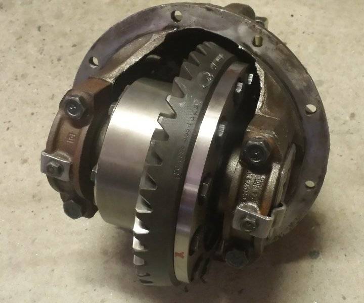

741 was standard even on the 383 four speeds, and they can take abuse. I found that all the C body cars I've had used 742 cases, at least the 383 and 440 cars, so you could put something together that way if you want the 1 3/4 vs 1 3/8. My 383 GTS has a 741 case, but I didn't realize the housings twisted under hard use, but I'm old and 40mph is about it for me.lol

It's the deflection of the case as noted. Spitting teeth. Sometimes blowing the caps out the back.

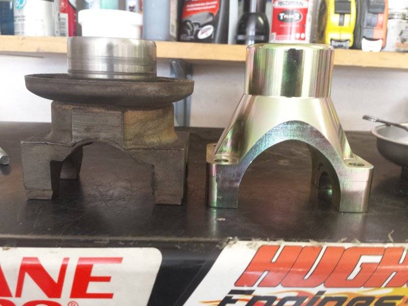

Nothing wrong with a 741 on the street or even on the track. I have a 741 in my 69 GTX, TruTrac differential, 3.55 gears behind a healthy street motor. No problems even on street legal M/T slicks. I did replace the yolk with a billet one from Mancini since the stocker looked rough.
