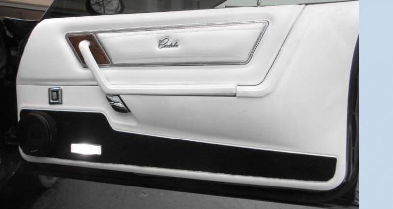

Will door panels on these cars exchange? more specifically, can i run the much better looking panels from a cordoba on a 78 monaco?
Here's what i want to run...I can't even find a google image of what my car actually has on it now to compare. I guess i'll have to take a pic of it tonight.
How difinitive is "should".....lol....I mean we r talking about a Body style that has 4 non interchangeable quarter windows over a 5 year run...
I took some measurements of the doba door pictured that may help.
height approx. 22.25 in
length of felt (top) 42.75 in
length at seam line (middle) 45.75 in

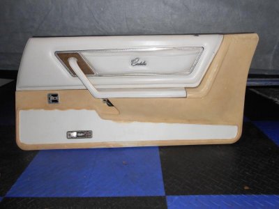

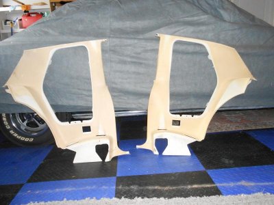

Here are some pics of door panels and rear kicker panels that I have. The passenger side panel is quite brittle at the point near the rear window and part has broken away.
thanks! does the spot where the vinyl is separating appear fixable? i guess i don't know whats holding it on...
It tucks under and is glued. had a similar issue with the one in the first post to this thread and it was a relatively easy repair.
It's amazing how these white panels just vaporize before your very eyes. Better off finding dark colored ones and painting them.
Gotta an old set of white ones myself and yea they just crumble whenever I move them.
