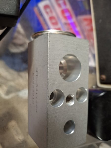

I got a 75 plymouth fury, trying to get back on the road after being stored for 30 years, oem condenser, lines, compressor ect gone.
I have original evaporator and evap fan and dash controls, trying to cobble working system together.
bought new expansion valve from rock auto GPD-3411284.
My trouble is I cant find a way to connect hoses to expansion valve, I would really like an adapter to go from expansion valve to threaded nipple of some sort. Only thought so far is to buy random hoses with a manifold for expansion valve and chop and Frankenstein something together.
any ideas, part numbers, where to start, greatly appreciated
I assume you are having the hoses custom made?
correct i bought a universal compressor, condenser, hose kit
You could call Vintage or Classic Air and see if they offer an adapter. If not you could make one out of aluminum and tig the fittings to it. Just use the old factory line for a guide.
