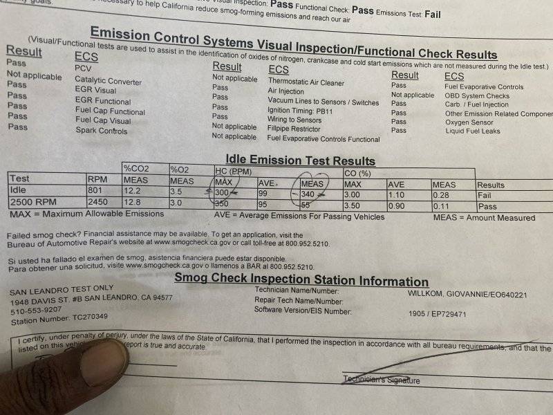

I have a motorhome, 77’ Dodge American Clipper 440 with low compression and a vacuum leak. She runs fine as far as I’ve had her. Didn’t pass smog. Got quoted 11k on rebuild but would rather hold off.
The power brake booster is leaking and low compression.

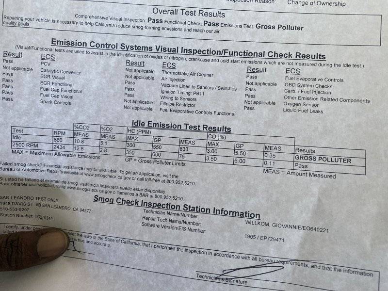

Well you just got screwed.... Four values that need to pass to pass a smog... Three of those values your well below... One you missed.... Unfortunately your smog guy didn't pretest, he sent the results directly to Sacramento & now your vehicle is tagged as a Gross Polluter in the system.. So you can't go to just any smog test, its gotta be "Star Certified" and at least in the past gross polluters had to get smoked every year....
Whats the deal with the first smog? Your showing two smogs, neither pass but the first one is much cleaner than the second....
Got it thanks. Well, I was attempting to get a smog waiver and needed to provide a second failed smog test but I was denied because ownership is undergoing change. Not sure why the second smog test is so much worse but I was told by the shop who quoted me on the rebuild said that if a second smog test was done it would show up as a gross polluter.
