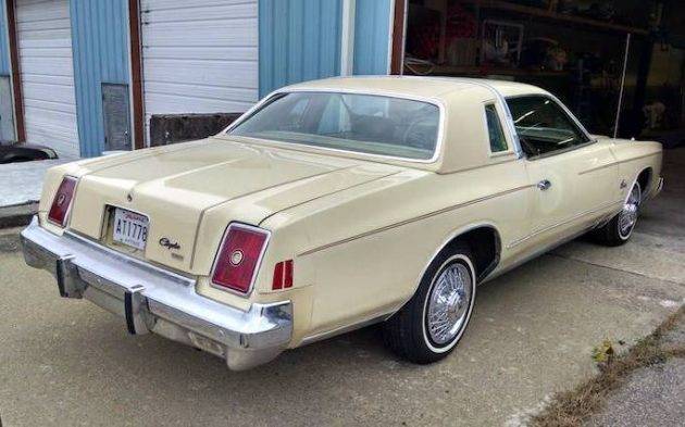

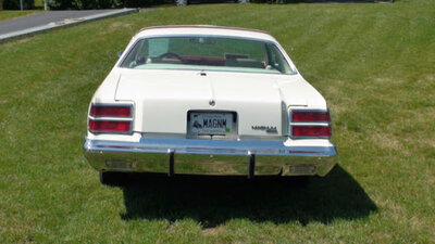

Can anyone tell me if a 79 magnum rear bumper will fit a 78 cordoba? I do see some differences but not sure as to the width. Im not trying to go full white trash but 78-79 cordoba parts cars are real hard to find in decent shape these days.
They should fit the same. Both are later B-Bodies, and aside from minor styling differences, 99.9% of the people could not tell the difference. If you need any 78-9 Magnum/Cordoba/Chrysler 300 parts, I may have what you need.
