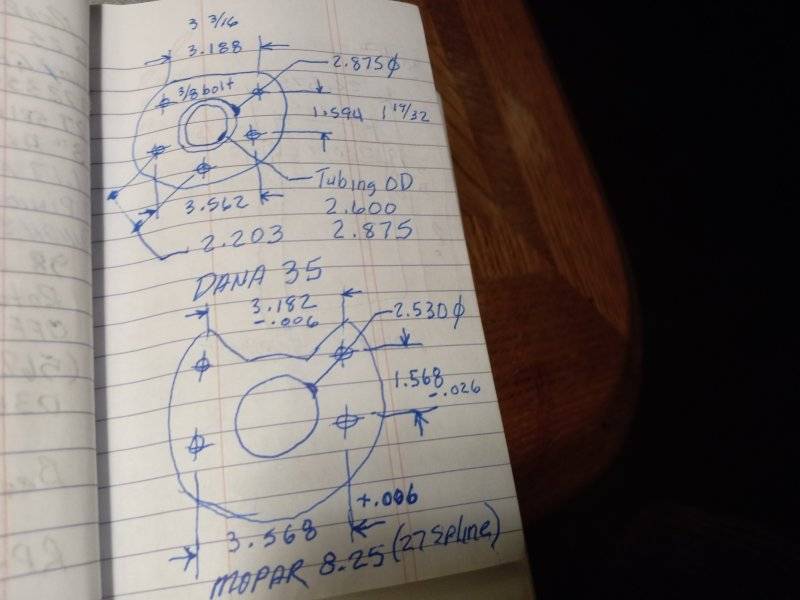

I did the same as you
describe.
The differences between the
bolt patterns are negligible.
I bought this kit but it may
not be quite what you're
looking for, for your
performance needs as
these calipers are only a
single piston. OK on a drag
strip, and they have the
emergency brake shoes
that are integral. No
issues stopping 3100 lbs
from 100 mph to 0 in
short order. For reference-
the front disc are Ford 11"
vented.
Any kit that fits a D35 will
fit Chryslers 8.25.

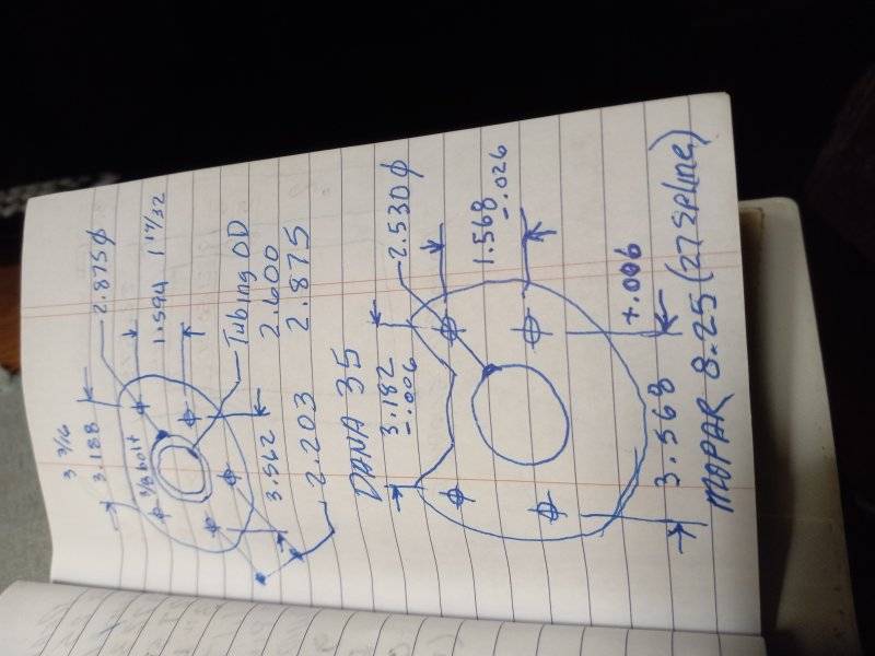

describe.
Chrysler 8.25 and Jeeps D35View attachment 1630240
vented.
[/URL]
fit Chryslers 8.25.
Thanks for clarification, thats a real neat frame and suspension you have there also! For older truck cab? Have no clue about that stuff but seems like it should drive like on rails with that frame!
My brake set was single piston aswell, but my 68 satellite just has mild built 318 so its not exactly a rocket and is built for cruising mostly so Im thinking it should work fine. You can get slotted/drilled rotors from rockauto too tho, but overall buying only the backing plate from summit and rest from rockauto seems to be cheaper than the whole set from summit.
Main point I was kinda going for with this conversion was more easy brake service over drums and extra safety should the axles or c clip fail, better braking is a plus

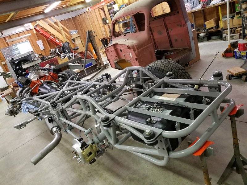

Thanks.
The chassis fits to 1940's
Plymouth or Dodge pickup.
I've been familiar with the
similarities between the D35
and 8-1/4 for quite some
time.
I've owned a few Jeeps but
this project is the first
Mopar.
