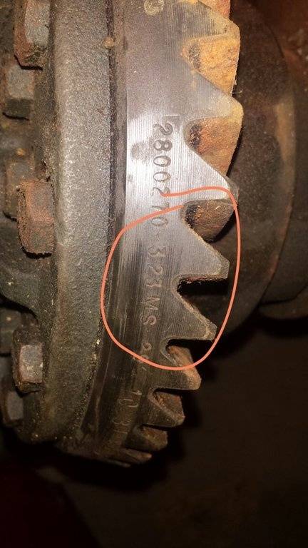

Also, if you look closely at the ring gear, somewhere on there it should be stamped "3.91" and people like to see that stamp when they buy gears. Just turn it a little bit & take a picture.

The gear oil pretty much like sludge. I quickly looked for stamp but didn't see. I'll keep looking.

Your looking for this
Yep, after wiping sludge away, found the stamp! 3.91! Thanks!
