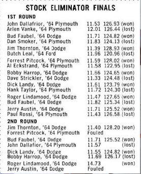

Well it wasn't until 1966 that the Dana was introduced in Chrysler Big Block vehicles. So how many Stock and Super Stock records were made before that time with 8 3/4 rears? Think about it!

You make a good point but I was thinking about the speed and power back in those days. I was only able to find this from an article about the 1964 US Nationals. Times have changed.
