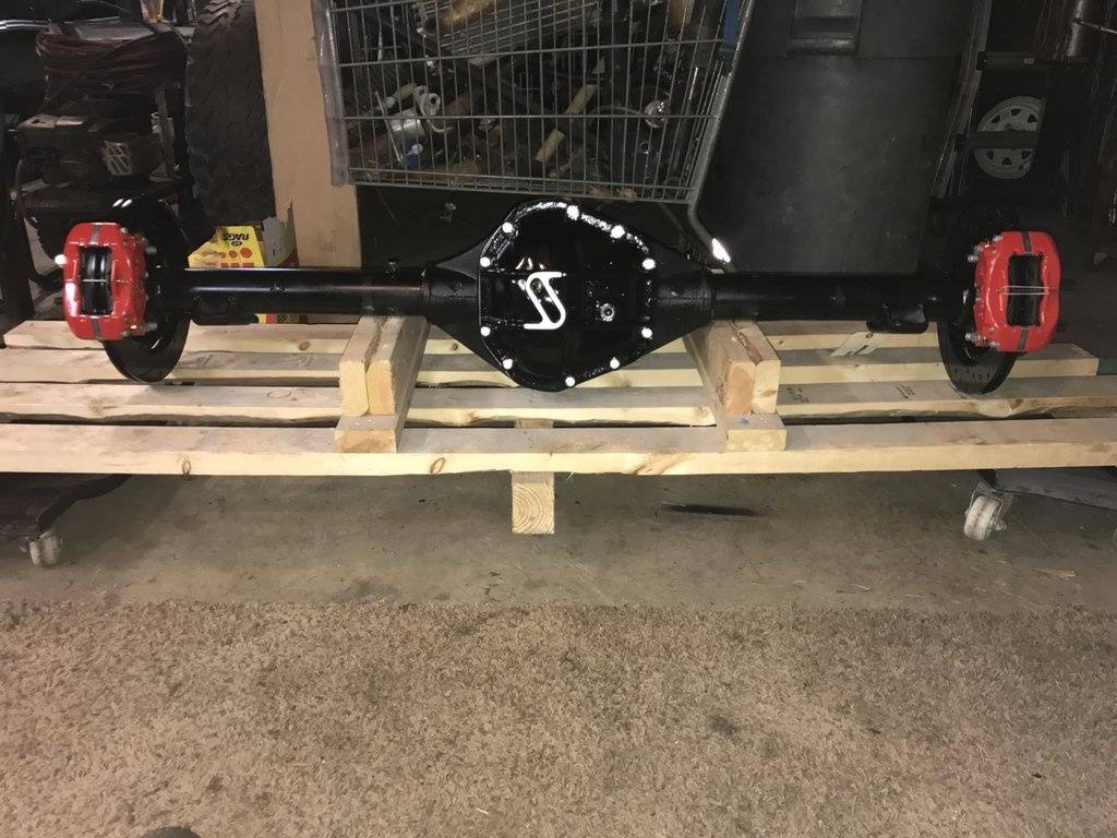

That's what happen to me, started the rebuild on my 8 3/4, called dr diff and he told me do you plan on leaving the thing out on the street somewhere. lol so dana I went and am very happy not only strong but looks great
