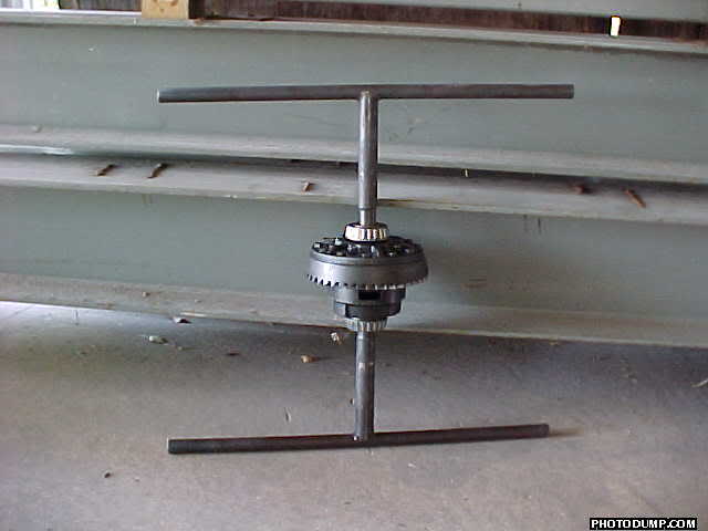

5 bolts hold the axle retainer plate in place. Also, check the splines in the SureGrip to make sure they are aligned. Many people that put these together don't even think about that and if they are not aligned, you will have a very hard time getting your axles all the way in. I made a set of tools to check the tightness of used units plus I use them when I rebuild them. I stick one in a vise and place the carrier half on it when I start loading the parts into it and then use the other to make sure they are aligned before I tighten it up.

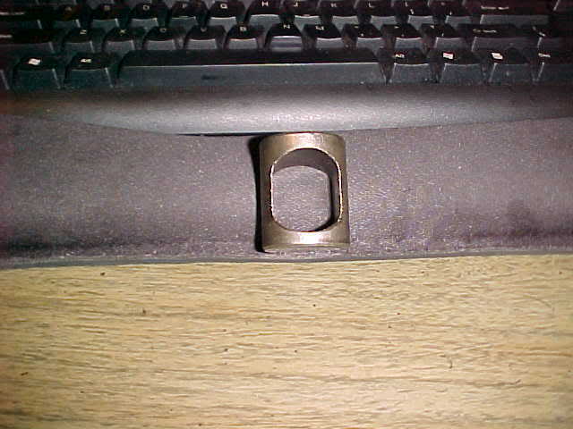

I think he needs to be sure he has the little spacer in there too for axles adjustments doesnt he?
The thrust pin. Yup. In the unit I show (cone type), the only way for it to come out is to take the unit apart. It looks like this and is trapped.....
The one that's in the clutch type unit is a two piece design and is pretty small and can come out with improper bearing adjustment (too tight) on the axles. I don't have a pic of it tho.
