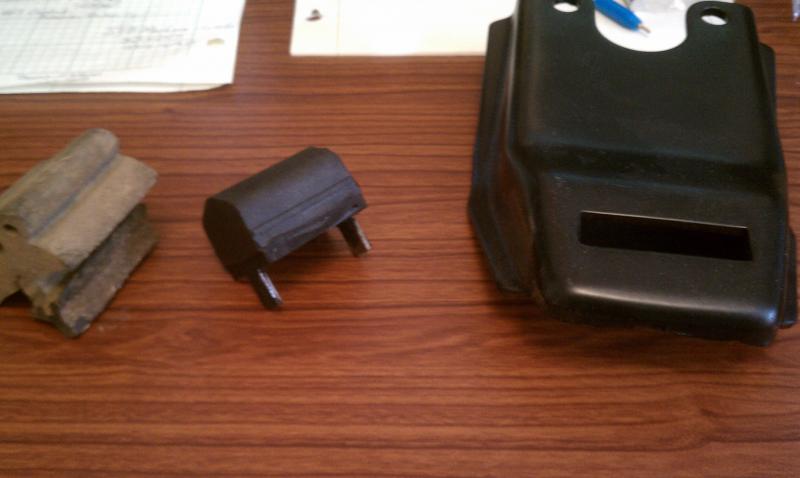

Just completed complete rear axle resto on my 73 bird and I'm looking for the rubber for the snubber. (just the rubber) does anyone sell a new one? Plug.
Hey Plug,

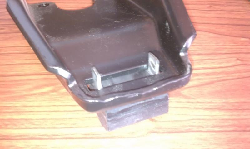

I knew I took these pictures for a reason when I did my restoration. First, unless my center section is an odd one, the snubber I see every where is wrong, as you can see in the pictures, the one of the left is correct, and the one in the middle is wrong, as you can see the middle one does not mount to the bracket for the snubber. So, I was fortunate to find a new old stock one on a consignment site a few years ago, and I have not seen anyone with the correct one since. Hope this helps, and hopefully someone knows were they are available.
