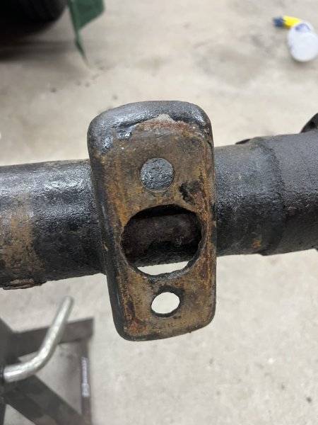

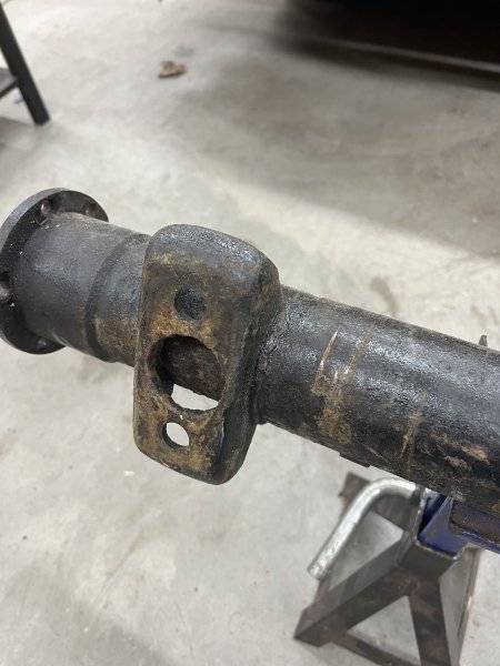

Mine look like the center hole has been blown out with a torch!!
Whats the normal hole diameter in the center?
is that housing an 8 1/4? if so, it probably came out of a volare/aspen.
1/2 is pretty close. Seems to be a variant on center bolts. Someone hogged those out for later model isolator's.
Thanks. There wasn’t anything in there as far as a spacer/isolator. I wonder why an isolator, they’re bolted so tight I don’t think it would make a difference.
I think I’m going to weld some thick washers in.
