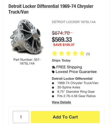

So far, it appears the best bet for better carriers are these two:

Googled 35 spline axles and spool. Ebay shows a lightweight steel 35sp spool, for $125 plus shipping, and a pair of 35 sp axles for $300 with 3" studs and bearings. Both from Dr Diff. Strongest for least money, saving a few bucks for the dana.
