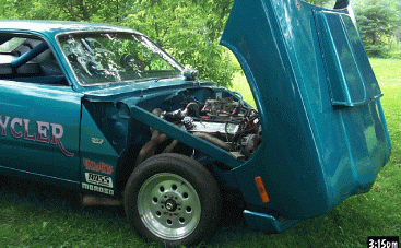

I run an 8 3/4" Mosier axled 4.56:1 gear in a 10 sec A-body. With a spool. Has held up 3000 lb.
