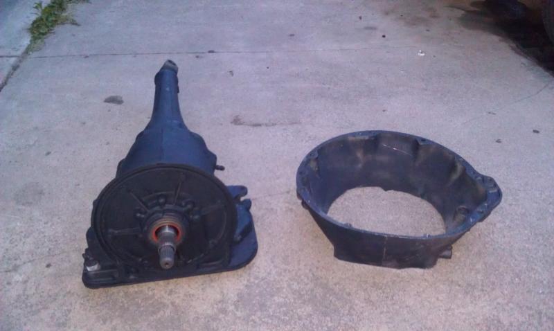

I also just started using the J-W Bellhousing on mine... Making it's first full power pass, I managed to snap my trans bellhousing in half!!:eusa_think: I'm not sure what caused it, but it will never happen again!!!
I have to say,,, it's a little un-nerving staring at a perfectly good "replacement" 727 with a Matabo cut off wheel in your hand!!!! LOL!
The bellhousing is SOOOOO much more beefy than the stock housing!!!
