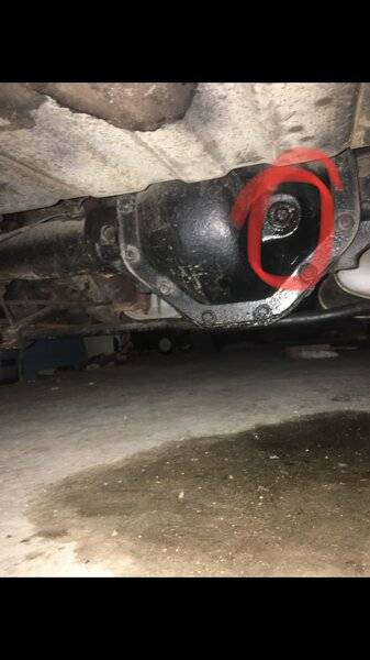

How do these plugs get removed?
figured I'd ask before I start prying.
Thanks,
John
Hard to see in the pic, but some are pipe plugs that have threads, and some are rubber plugs that pry out...
I had the same diff originally on my 79 Magnum it's a rubber plug. Remove it clean it well and put oil resistant silicone and put it back
