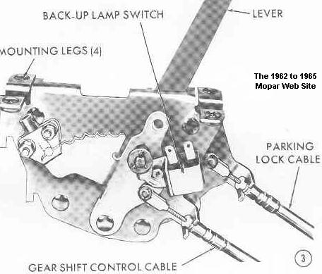

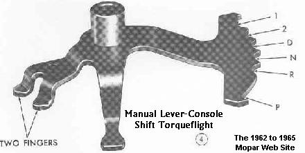

In addition to the gating provided along the top of the lever bracket, each of the six positions is detented.
torqueflight manual lever console shift torqueflight
The back-up light switch is mounted on the cable operating lever and is actuated by a hump on the side plate when the shift lever is moved into reverse.
