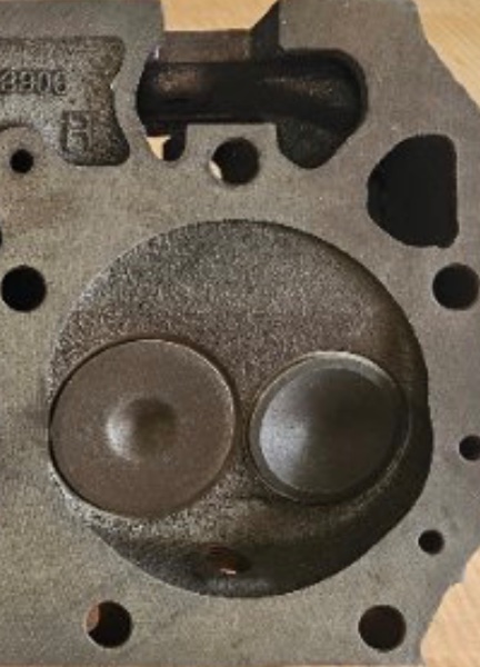

so i just bought a set of 906 supposed heads. The valves seem small to me. the heads are only cast #on the bottom. The valves seem kinda small - Too far apart. Does anyone know if these heads coul be small valves? the last set I remember looking at - the valves were damn near touching. Any thought? thanks. I only bought these heads to help him out. I just don't to find out that they are NOT real LARGE valve 906. Is there something wrong with these? thanks

they just seem to have a bigger gap between the valves. I'll take s pic and post it. to help show. but they seem small.
thanks to everyone...will post some pics tomorrow. not feeling to good right now. Old man health stuff right now. thanks you guys

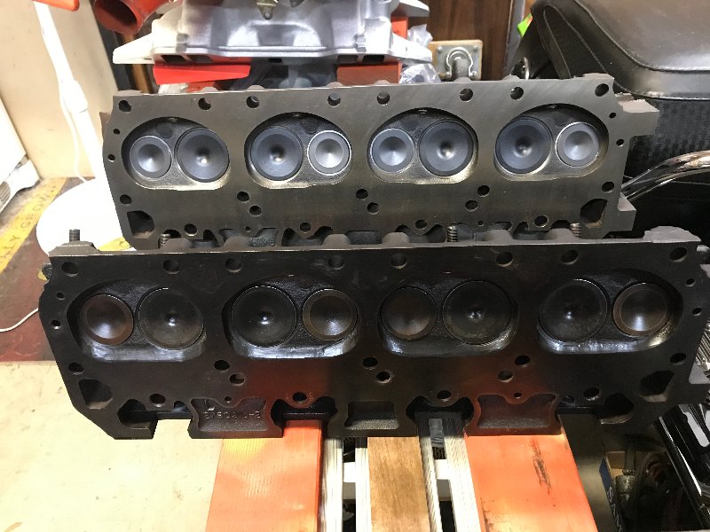

Do the valves look like these?
Here is a 516 head in the back with 1.60 Ex. and a 915 head in front 1.74 Ex. to compare the valve difference.
906's are the same exhaust valve size as 915's
appreciate it bro. Clearly I dont know much about chryslers. THe last set of 906 heads i had seemed to have bigger valves. that's why i was curious about these heads. I only bought em to help out a friend. I live in the desert and even with a fat 4 row radiator and aluminum heads, it still runs a little hot in the summer. thats why I a switched to aluminum in the first place. I can't run the high compression chamber heads w/ these particular pistons. Got a clean set 915's also...Just cant use em w/this bottom end. Thank you for the info bro. It did help me out. I think these 906 are ok. Ugly, but can be rebuilt. LOL Have a great day... David
