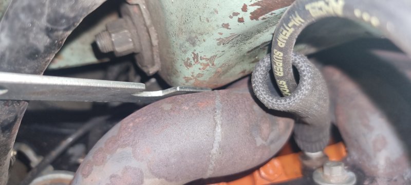

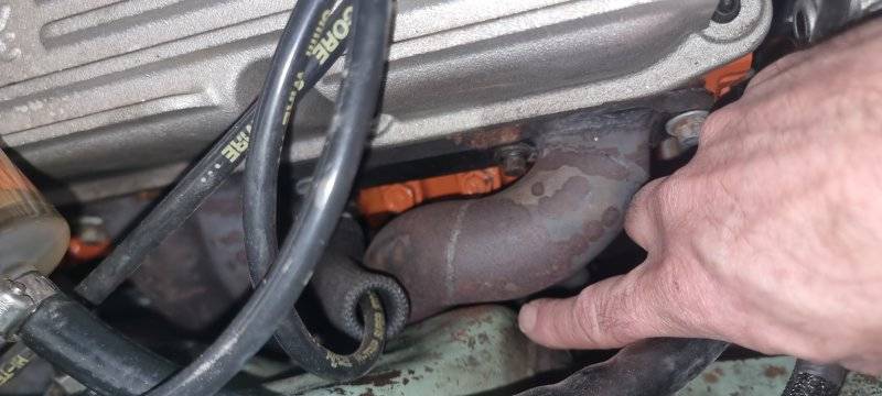

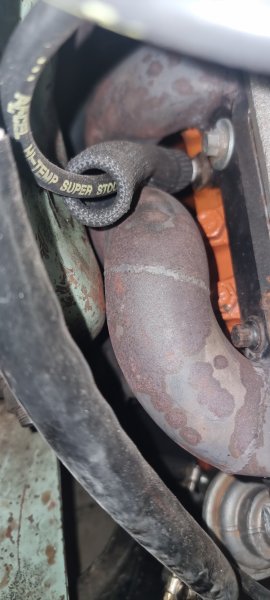

Hi all
Looking at replacing 906 heads on 69 440. (Mechanic thinks the car has a cracked head as has a combustion leak and some oil in coolant).
Just looking at my options before getting the heads removed( have a spare block in case there's issues there).
As you can see from the pictures, the right side of my engine bay is very tight.
The block hugger headers have been modified for clearance against the shock tower of the car.
I wanted to install Edelbrock alloy heads but after researching, it looks like this could be impossible due to the tight clearance.
I read the heads need longer plugs than the original heads and I assume that they must be wider to need the longer plugs.
Can anybody estimate how much more room these heads take up in the engine bay?

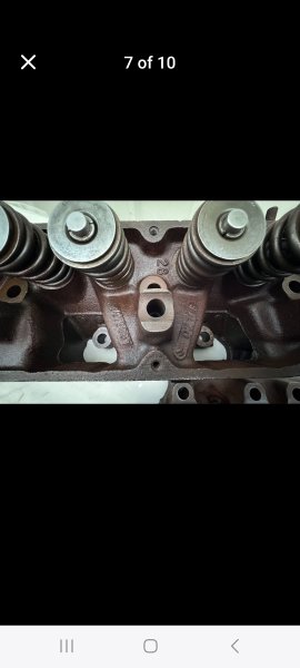

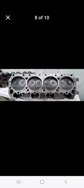

Assuming alloy heads aren't an option, I have a chance to buy some rebuilt 452s( I've posted this now, don't want to miss them if they are a good option).
I am wondering if these are physically the same size heads and will bolt straight on? Also are the 452 valves the same size as 906,or does this depend on what size motor the heads originally came off?
As always, really appreciate any replys

The "452" head is an improved version of the " 906" with hardened valve seats, and possibly better porting. Same valve sizes. Dimensionally identical. I use them on my 440's.

Looking at the first picture you put up it looks your right hand is resting on the fuel line.
In the second picture it looks like the fuel line (hose) is getting a little wavey from the heat.
In the last picture it looks like the fuel line is resting on the piece of metal which is also physically touching the header pipe.
I would reroute that fuel line.

I think the 452's is the right answer for you.
