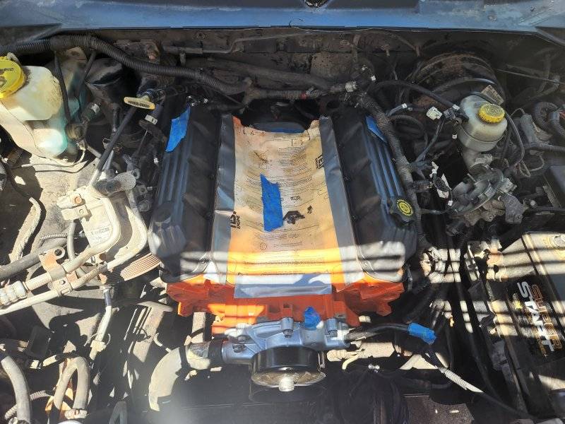

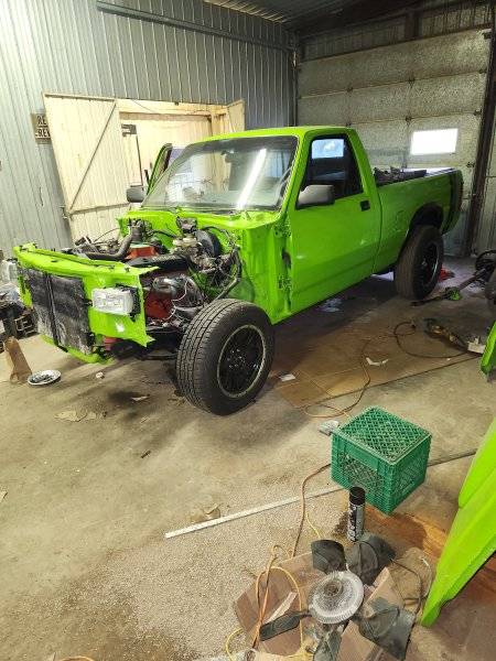

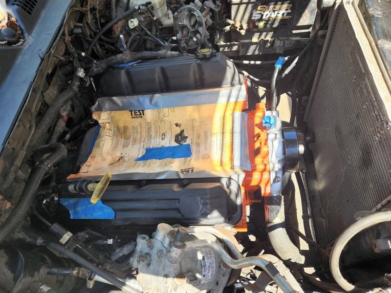

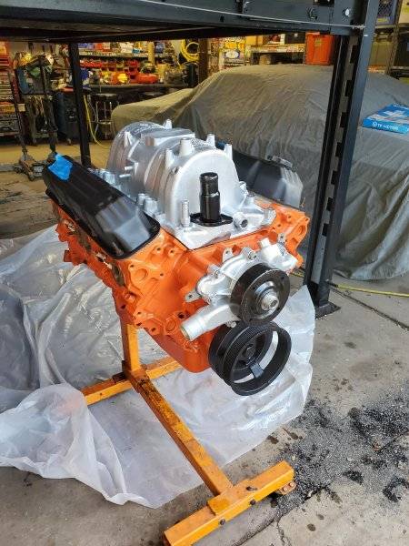

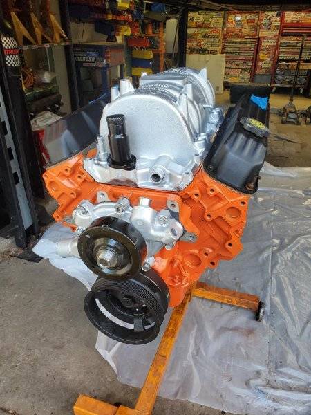

I am in the process of stuffing a w5 headed 340 stroker motor and an a833 into a 96 dakota.
Luckily I found swap mounts and long tube headers.
Ditching computer and planning holley sniper
